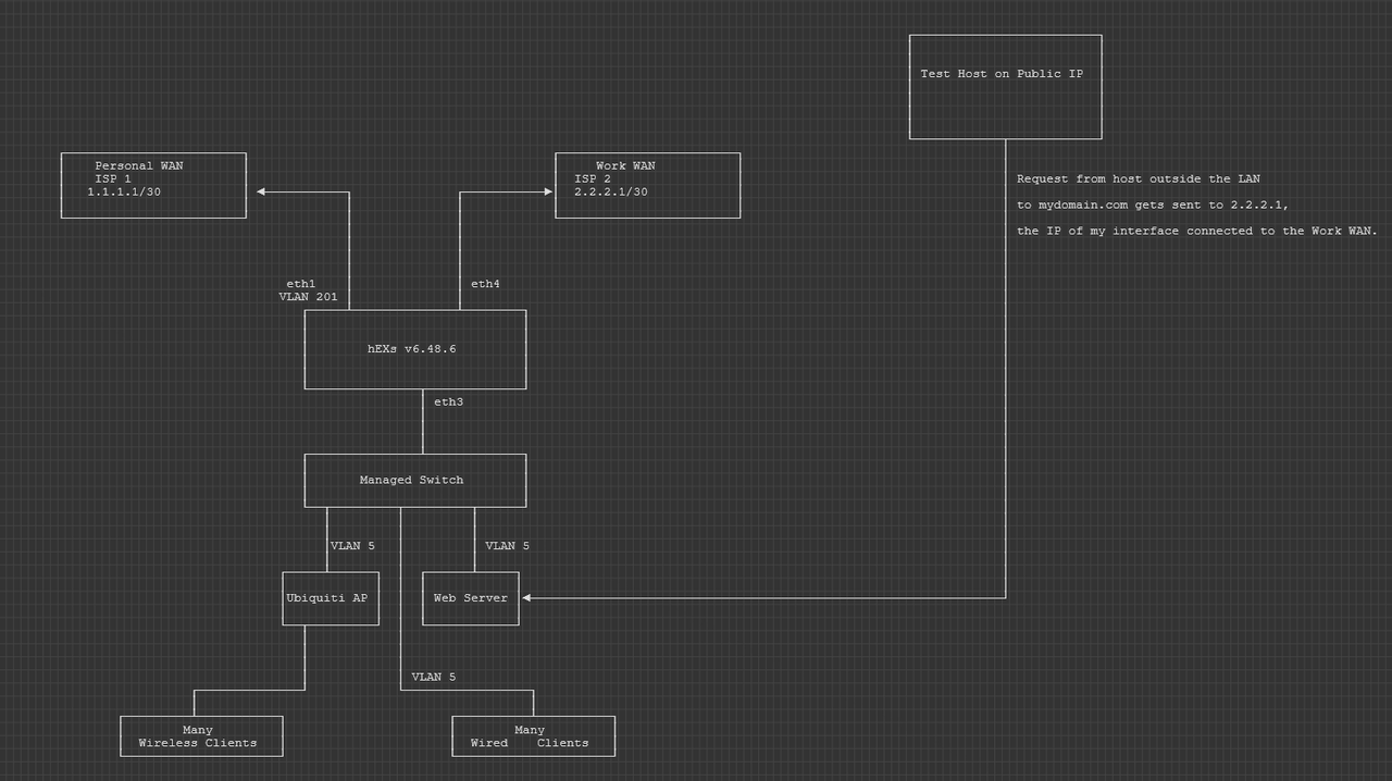

Network engineer here. I’ve been stuck on this for a few days now. I’ve made a little bit of progress but ultimately I am stuck. I’m running Router OS v6.48.6 on a hEX S.
I have two WANs at home (no load balancing or anything fancy, they just have different metrics). One WAN is for work, so I have a bunch of static routes to send traffic out that link. The other WAN is for normal home networking needs and is the best default route in my routing table.
I have a couple of servers at home, and some DNS records that point to my work WAN IP. So, I am attempting to dst-nat (port forward) HTTPS traffic that hits my work WAN (via the A record I’ve published). The traffic is getting dst-nat’d to my server just fine; I can see it show up on when using tcpdump on the server. The server is in one of my LANs with the rest of the clients that normally get routed out the personal WAN, not the work WAN. So, if traffic comes in on the work WAN, having it go back out the personal WAN won’t work. To prevent this, I’m using the mangle feature to apply routing, packet, and connection marks on the incoming dst-nat’d traffic so that I can catch them on their way back out (assuming the “connection” mark will apply to both the incoming and outgoing traffic). Here are my mangle rules:

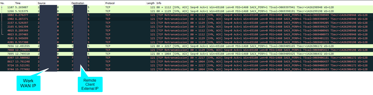

The problem is the return traffic back to the client. I have been capturing packets on the destination server in my LAN, on my Mikrotik router, and on the remote client that’s trying to access the server.
On the server in my LAN at home, I see packets coming in and replies going back out.
On the remote client, I do not see ANY return traffic. I only see the requests going out with a destination address of my work WAN.
On the MikroTik, I see the reply packets coming from the server, hitting the MikroTik’s LAN interface (assuming it’s getting re-translated), and then I see a packet go out the work WAN interface destined to the remote client’s external IP. The remote client is also behind NAT and I manage that end of the network too. However, many of the packets leaving the work WAN interface on the Mikrotik are retransmits for sequence 0, which confirms the remote client is not getting anything at all back.
So, I’m pretty sure this is happening because the replies from the server on my LAN are not being NAT’d back out the TCP port they came in on. In other words, I think the MikroTik is NAT’ing them out the correct interface, but not as part of an existing connection. But, in that case, I would at least expect to see the traffic hit the remote client (and subsequently ignore it), but it’s not. Plus, I don’t see any src-nat rules incrementing on the MikroTik interface.
Here is the packet capture from the Mikrotik that shows packets leaving my WAN interface and going to the remote client’s external IP.
Any ideas on what I can try? I hope I’ve shared enough of the details. Thank you for your time!

Why dont you simply create one LAN dedicated to the work WAN. Since there is no network diagram i am probably missing the boat.
The fastrack forward rule was near the bottom of my filter rules, right above a couple of drop statements. So, it wasn’t fully disabled, but it was pretty close to being disabled. Only 3k packets out of 119M have hit the fastrack forward rule since the last counter reset. I have disabled the fasttrack forward rule per your troubleshooting recommendation. The issue is still happening with TCP re-transmissions going back to the remote client. Also, I’ve moved the remote client out from behind NAT and it’s now on a public IP address to help reduce the complexity of the situation. The remote client is not receiving ANY packets back from the web server on my home network, as if my MikroTik is blackhole-ing the responses somehow.
There are several reasons but it all boils down to the fact that I only want to use the work WAN for traffic that needs to go out of it (or come into it, in the case of accessing the server on my LAN).
  • The work WAN connection has much lower bandwidth compared to my personal WAN (150 Mbps down, 10 up for work vs. the 1 Gbps bidirectional throughput I get on my personal WAN)
  • The work WAN has high latency as it’s on an overly congested DOCSIS HFC infrastructure
  • I work for the ISP that provides the WAN connection, so I don’t want my normal internet traffic to be snooped on
  • Lastly, I work from home most of the time, so I don’t want to have to switch my computer’s network (or deal with routing on the computer itself) every time I need to access resources through the work WAN.
    I don’t think a network diagram will help too much in this case as the problem is clearly with the MikroTik router configuration, but I quickly put this one together in case it helps you think of any ideas.

Great idea on trying ICMP. I just added the rule to my firewall table and ran some pings from my remote client. I see the requests coming in and the replies going out, but I’m not getting responses back on the client. Oddly enough, I see two replies for every request:
… where the 7…35 is the remote client, and the 2…0 is my work WAN interface.
The dest. mac on both replies is the same (the upstream layer 2 neighbor). It is strange that there are two replies going out within 1ms of each other for every request, but even with that behavior, I should still be seeing the packets arrive at the destination, and I’m not getting anything back at all (confirmed via tcpdump on the remote client)
When you have a look at the replies, you can see that they differ in size by 4 bytes, which suggests that the larger one has a VLAN header (as the dissection pane will show you). That further suggests that these replies are sent via VLAN201 on ether1. So maybe it is time to post the complete configuration, anonymized as per my automatic signature below.
If you run /tool sniffer quick ip-protocol=icmp while pinging from the outside, you should see through which interface the requests and replies pass.
