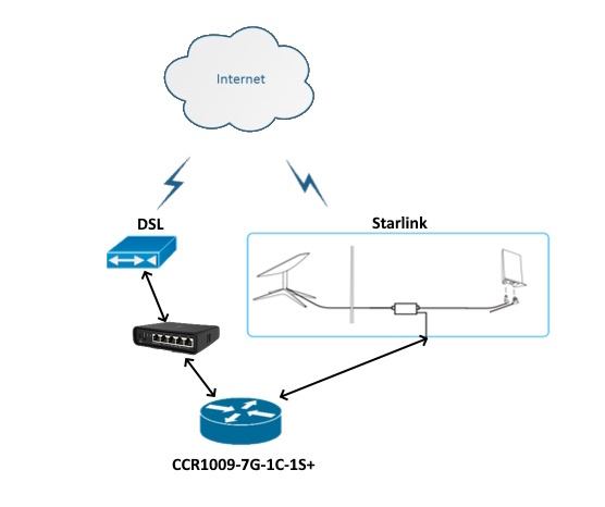

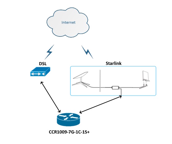

Please refer to the image below and export file. My current setup is working with the Starlink connected to ether2-WAN with no problems. I would like to use the existing DSL modem currently connected to the combo-WAN port as a workaround to remotely access the MikroTik CCR1009-7G-1C-1S+ router from a remote location. I don’t care to load balance… all I want is to access the router from remote site. The Starlink is set to bridge mode. I have spent many days looking at some of your postings and I am sure I’m missing something from the configuration shown below. Thank you in advance.
