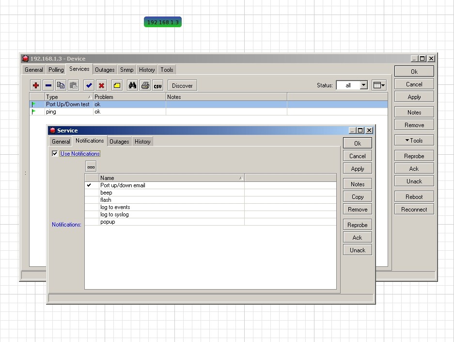

To get it to alert you by email you will need to setup a notification specifically for the probe we have created.
Create a new Notification and set it up accordingly…
Notification:
Name: Port up/down email Test
Type: Email
Server: SMTP server address (unless you already have a default one setup in the Dude)
To: portupdown@test.cc
Subject: can be left as is for testing
Body: Leave as is for testing
Now setup the notification for the probe. see below.
That is pretty much it.. test it on a port you can pull up and down regularly to make sure the probe and notification are correct.
