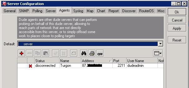

I did see the link you provided already, I guess I’m not that good as you are because I didn’t manage to get it to work on our server.
This is what I did so far:
  1. Install the dude on our client’s server (changed default use/pass)
  2. Changed router/firewall to redirect to the dude server via port 2211
  3. on our dude server → added an agent (see attached) with the WAN IP of the remote server
It seems that the remote agent is not connecting..
Usually this either the firewall on the client side or the way that your main server is connected to the internet.

I found the problem, the user/pass I changed were the wrong one.
It’s all working now.

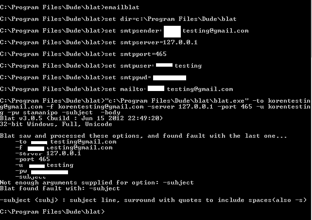

but - its not working for me
I did like you said but I get no mail
when I press test on the Dude , i can see O.K at the line
this is a capture of the CMD
maybe need to change the SMTPServer?
hipe you can help me
Thanks ,
Nope, the smtp server is correct (localhost), the error is in the subject line as suggested by Blat. Did you check that you added enough quotes in the command part in the notification?:
C:\blat\emailblat.cmd "Monitor: [Device.NetMaps] map - [Device.Name] probe [Probe.Name] is now [Service.Status]" "Hi there!||This is TheDude from the monitoring server reporting:||at: [TimeAndDate]|on map: [Device.NetMaps]|Device: [Device.Name]|Probe: [Probe.Name]|Status: [Service.Status]|Problem Description: [Service.ProblemDescription]|Changed since: [Service.TimeSinceChanged]|Last time up: [Service.TimeLastUp]"
