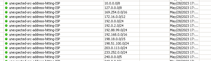

I am not sure this would work because I have a lot of entries with the name “unexpected-src-address-hitting-ISP”, they include things like rfc1918 ranges, etc.

You need to set a unique comment for this entry in your list=unexpected-src-address-hitting-ISP.
:local currentIP [/ip dhcp-client get [find interface=ether1] value-name=address]
/ip firewall address-list set [find where comment="dhcp-client-address"] address=$currentIP
I just set another name it works great, many thanks!
