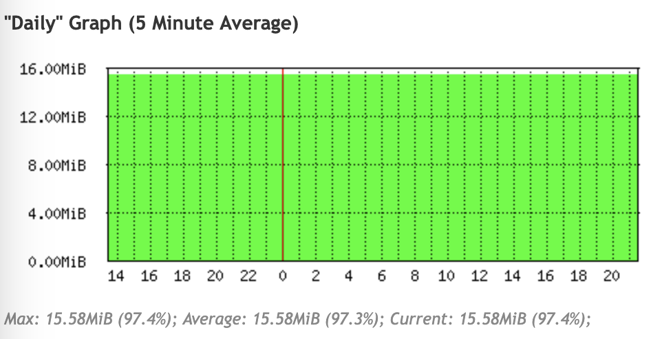

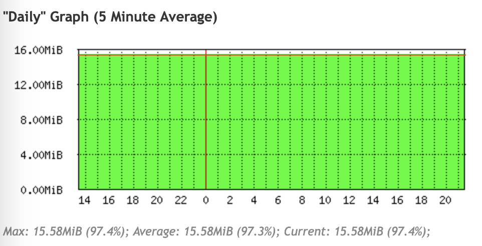

It grows, but not much in my case running ROS 7.16.2. I have several schedulers that changes configuration, one for eg. performs changes by adapting 25 Queue tree rules several times at day. I didn’t monitor how much space is reduced by day, but when creating backups occasionally they are getting a bit larger, less than 1KB per backup so I’m not worried much, still having currently only 420.0KiB I’m not to happy with this either.
Probably this disk space growths depends which configuration is changed and how often.
Nope. On mine, the free disk space shrinks by 4096 bytes every 5 to 10 minutes currently, and every 128 kBytes it gets freed in bulk and the cycle repeats, and neither me nor any script touch the configuration during that time. I.e. the ghost is fully autonomous. Two devices under my responsibility behave like this, three other ones don’t. All five of them hAP ac² running 7.16.2.
Does ROS maybe uses swap file for VM on flash and it’s changing depending on RAM usage? :slight_smile: My device is with similar specs (Chateau LTE12) but it has more RAM - 256MB. Also I’m seeing dynamic some small disk usage changes, but much smaller.
It is visible that is not straight line, could be just some small temp files used by system processes.
PS.
Actually it’s straight, maybe I seeing optical illusions because of dots :slight_smile:
I rebooted router yesterday so I don’t have much graph history, but I’m sure from the past when I was observing this graph that disk size varies, but not much in my case.
The free space remained constant for some 4 months while running 7.16 (without any reboots or some such) … after upgrade to 7.17 it did shrink a bit. 7.16, however, did use a bit more RAM (not a problem on my 256MB unit, but could be a problem on 128MB units) and quite more CPU … both went back to pre 7.16 levels with 7.17. I’ve yet to see if resource consumption will be stable with 7.17 though.
By chance, one of the affected hAP ac² has 256 MB RAM too, so that is not a remedy. And no containers run on any of them, so it’s not them swapping to the flash - plus, if the RouterOS itself needed to swap the RAM on disk, why would the free space get reclaimed every now and then. Also, the 5 to 10 minutes pace is a property of the current reincarnation of the ghost, it used to be slower before the last reboot.
Yes that’s true about swap and disk space reclaim, as I mentioned, disk space varies in small amounts, up and down, could be temp files or swap if used.
