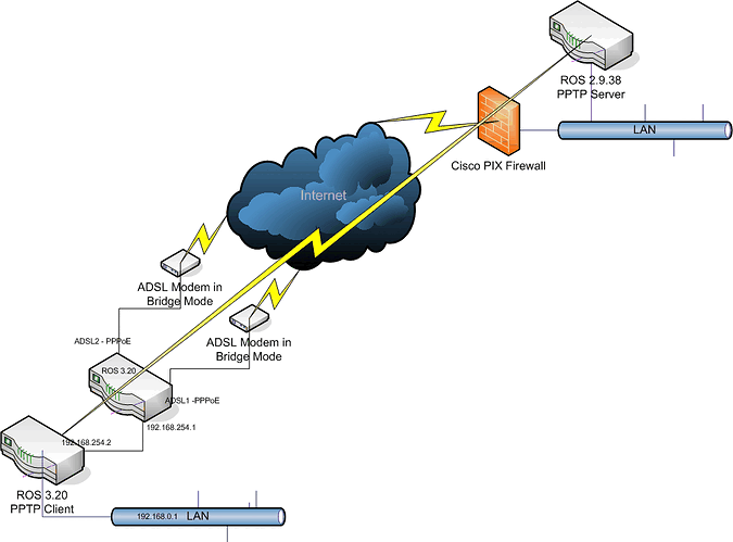

I then use a second router (RB532) which connects to the ECMP router as indicated in the attached picture. The reason for this is to get away from the problem where traffic that originates from the router itself (such as PPTP client from the ECMP router itself) is not handled correctly and creates all sorts of issues.
This config generally works well except that the tunnels that I create on the RB532 disconnect and re-connect at regular intervals (every 10 minutes or multiples thereof - i.e. 20 minutes).
