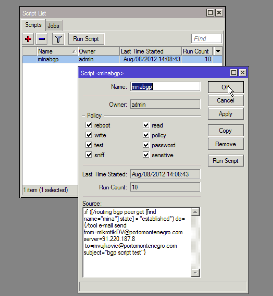

Id like to create a script which would email me if BGP session is NOT established. This is the only BGP state Im interested in. I currently have basic Netwatch configured to email me if ISP gateway is not reachable, but this is not enough.
Could you point me in right direction on how to configure this? Please have in back of your minds my programming/scripting knowledge is not existent

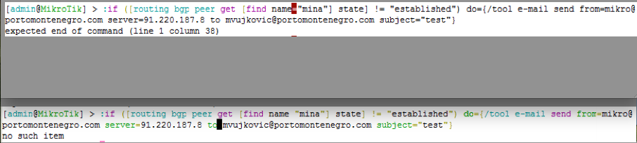

Tried manually entering the code directly into the command line, and got the syntax error at “=”. Second run was without “=”, and received no such item message. Any clue?
This script test BGP sessions and if not established if send mail, but If BGP was down more then horn then it send so many mails. how to prevent this type of situation and script only send mail once.
You need additional check.
If state is not established set global variable that peer is marked as down. Next time when script runs check and send email only if previously was established.
