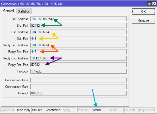

  • In this example the web browser running the PC with the LAN IP address 192.168.88.254 tries to open the web page https://cloudflare-quic.com/ at 104.18.26.14, which uses HTTP/3 & QUIC, thus UDP instead of TCP. The "public" IP address of the router is 10.12.1.249. A connection tracking (conntrack) entry will be created, that we can see in the following screenshot:
  • As we can see, on the PC the browser picks the port 52792 and sends the UDP packet with the source address & port pointed at by the green arrows. The destination of the packet is pointed at by the yellow arrows (104.18.26.14:443).
  • The SRCNAT masquerade rule will translate the source address and port, the address will be changed to the router's IP address on the WAN port, 10.12.1.249, and the source port to some free UDP port. In this case, it happens that the original 52792 is available on the WAN side of the router, so it will be used right away (but if the router is busy and has many active NAT mappings, then the port might not be available and a different port might be chosen). We see this mapping pointed at by the purple arrows, under Reply Dst. Address/Port. No DSTNAT has been performed, so Reply Src. Address/Port (orange arrows) have the same value als the original destination of the packet (yellow arrows). The srcnat flag is active (blue arrow).
  • When the Cloudflare server sends the response UDP packet, this packet, when it arrives at the router, will have source 104.18.26.14:443 and destination 10.12.1.249:52792. This reply packet will be associated with this existing conntrack entry, because it has the source matching the orange arrows, and the destination matching the purple arrows. The NAT will be reverse and the destination of this reply packet will be changed to the values of the yellow arrows. Because the conntrack entry is found, the packet has connection-state=established and will be let through by the rule of the defconf firewall. The router will then forward the packet to the original endpoint 192.168.88.254:52792 on the PC where the web browser is listening.

    This rule will do the same source address rewriting for packets leaving the WAN interface of the router, by translating the source endpoint (green arrows) to the IP address of the router on this interface and an available port (purple arrows). The port might be the same as the green original (if randomise-ports=no and the port is available) or not (if randomise-ports=yes or already used by other sources). But the important difference is that this green arrows to purple arrows mapping is consistent. A given green endpoint (address/port) will be translated to the same purple arrows endpoint, regardless of the destination address and ports (yellow arrows).
    Which means the www.bbc.com situation above with masquerade will not happen. If the web browser uses the same green source socket 192.168.88.254:52792 to send packets to Cloudflare and BBC, the EIN SRCNAT will cause the outgoing packets to both destinations to have the same rewritten purple source 10.12.1.249:52792.
