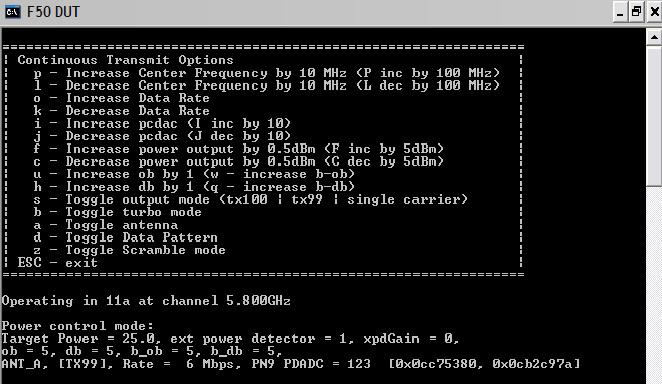

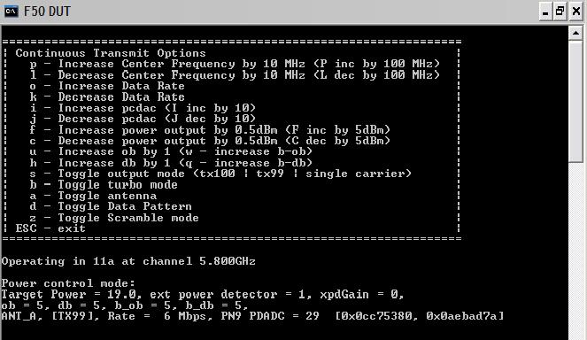

My name is Lawrence from Dbii Networks and there always many questions regarding “Real power” for certain cards such as XR5, 8603, F50-PRO. I recommend this website if you have any questions on understanding what is happening:
http://www.wifi-stock.com/file/ubi_mtik_power.pdf
If you really wanted to test out the actual power vs what the software is telling you you can try this method if you have the test equipment:
If you hook up a cable and attenuator, or read the power of the cards through the power meter or spectrum. What you see is for example:
F50 = 28-29dBm
R5H = 32-33dBm
These are negative numbers you see on the power meter----Lower is better----Ours is 4dBm better than R5H. R5H is actually rated at 25dBm so ours should be around 29!
Secondly, DONT make a comparison with the 28-29 you read on the power meter to our (offset power) of 27. They have ZERO relation. Before the signal enters the power meter there are a lot of attenuators.
This is only used for your reference on one way to test the actual power (b/c otherwise anyone can claim a high output power) This sample was done on only 2 cards we bought vs 2 cards from our production, so it’s not a good sampling rate to accurately determine the average of all the cards since there are small variations between cards. We do know what our average is, but only through your help can I get an accurate number of what you are experiencing as customers :slight_smile:

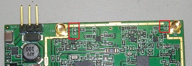

*I do have one question if you do have 8603 cards that don’t work. Cause I only have one of them that I’ve tested and I’ve attached the picture. But we were trying to test all manufacturers ESD protection and only with this card the shield cover was soldered shut (which was odd). After we opened it, we tested and there was no ESD protection at all. There’s a slot for it, but it was never added. So JorgeAmaral quote saying that it lasted through thunderstorms is quite interesting. As I mentioned, I only have one card so I can’t prove nor disapprove but I would be interested to know if your cards have the same empty slot.

I have about 20 of those engenous cards all on 5 gig. All at 130+ feet all attached to pacwireless 19 db aluminum enclosures(i just use the boxes as antennas and use 12 X 16 X 8 steel boxes for the boards etc.) with no lightning arrestor or 1/4 wave stubs. No failures yet after six or 8 months. We get quite a few thunderstorms in my area of Texas.
I use those radios because I like the external power connection to keep the power off those tiny pins on a high powered radio. But again I am a guy who thinks POE SUCKS TO NO END and gas arrestors are a joke.

The only issue I have is when information is misrepresented. It’s not so much as an extra dBm here or there, but more about other features. As you are aware, we make cards…but we do tests to see how the final result compares. I think customers like yourself benefit in the end, marketing is marketing…but how it performs on your network & what you see is what counts right? :slight_smile:. In this scenario, we just noticed that what is said was not on the card. A lot of local “asian” companies have this problem where they might say it’s “green” (apparently the popular word now), or in this matter “ESD” when they clearly didn’t do it (based on the card that I have). I just think that when I buy something, it should have what’s listed whether it’s a card…or anything. Everyone is working hard to make money…
I think it’s great that your equipment is working well…a lot of our other customers in other countries are not so lucky. Then again…people are still using XR5 (doesn’t have any protection either) as a backhaul and it seems fine too :slight_smile:. I think the main thing is not whether there are thunderstorms, but when the “induced” lightning does strike and hits your equipment…then it should matter more. I’m not really allowed to post up pics, but our customers have boards that are completely charred. Some have the ethernet ports burned…it’s actually quite interesting to look at, and also to smell a sweet charcoal sensation filling up my cubicle.
