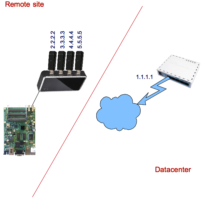

Please refer the this diagram for an overview of my setup:
I need to setup a transmission unit that will be constantly moving to different locations to broadcast live HD video. I have 4 USB 3G modems (with theoretical upload speed up to 5.76Mbps each). Each USB modem will be connected to a different wireless provider. Each modem has a static public IP address associated to it.
A EoIP tunnel is set up for each 3G modem. The four EoIP tunnels are bound together.
I cannot specify on which interface I want the EoIP tunnel to be effective. The router uses its routing table to choose the right interface on which it should send the traffic. The result of this is the following: All the upload traffic from the remote site uses only ONE 3G connection.
I clearly see in the interfaces window that the traffic is following the bounding directives (separated across all 4 EoIP interfaces), but the combined upload traffic uses only ONE WAN interface.
Any idea how to specify on which PPP interface the EoIP tunnel should work ?
The only idea I had until now is to use 4 different IP addresses on the other MikroTik Router as well and to enter static routes on the remote site’s router.
Thank you for your help,
Martin
I “solved” my EoIP problem by using 4 different static IP addresses on the router at the data center.
I now have a much more problematic issue and I hope someone will be able to help me.
On each modem I can achieve 2.0-3.5 Mbps in download and 1.2-1.5 Mbps in upload speed.
Once again, my goal is to broadcast a HD video stream from a single device to a single server… so I need to receive packets in the right order and I cannot use a “per connection” load balancing mechanism.
However, when I use the bonding interface, I have lower transfer rates than with a single 3G interface!
Any idea? Your help is much appreciated…
Thank you,
Martin
