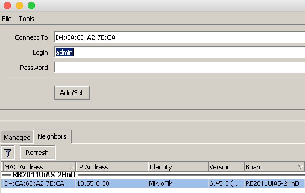

If you have Winbox loader open, does it find the Metal unit in the neighbor list? Can you click on the MAC address of the unit and then try to connect? Does that work?
See attached example
The unit is all connected and working perfectly on my network. Smartphone is connected, and speed test is fast. However, right this moment, Winbox on this PC on the network can see my other unit but not this one either by IP or MAC. I got the MAC address just now off the back of the unit. Says “ERROR: could not connect to 74:4D:28:D5:C0:78” There was a second MAC ending in 79. Tried them both. Can’t connect with my browser to the IP 192.168.1.25. The IP does show normally on my IP scanner software. Very puzzling since it’s working perfectly with SSID, passwords, channel, BW, etc.. It was a huge hassle to configure it under these conditions, however. I was experienced enough to do that since I have the other Metal 52 unit. I could stay with it on Winbox once connected to do the configuration, but it will never connect again. So this one can’t be reconfigured in any way without hard factory default reset and going through those hassles again.
