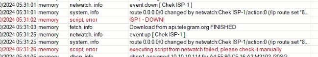

What can be the problem, this script is used in several projects and had no problems except for one case. Here the main channel ISP-1 wifi bridge, backup ISP-2 starlink. The script in netwatch switching can once work completely the second time causes an error message in the log.
The script disables/enables the default route through ISP-1, then clears all connections, and displays a message in the log and sends a message to telegram. According to the logs it turns out that the error is caused by line 2 connection clearing. Help me where to look

@rextended in first screenshot fetch logs successful execution which is strange if is not permitted, also if is fetch error, it will be logged “ISP-1 UP” or “ISP1-DOWN!” before script error message because :log warning “ISP-1 UP” or :log error “ISP1-DOWN!” commands are executed before fetch.

what features I have found
1.The log outputs messages in a different order than the order of lines in the script.
2. I suspect that the problem lies in copy-paste through a remote session. Because I had to copy the line of sending to telegram again and the error disappeared, visually the lines are exactly the same.
3. I inserted an empty line with a comment and the error disappeared
