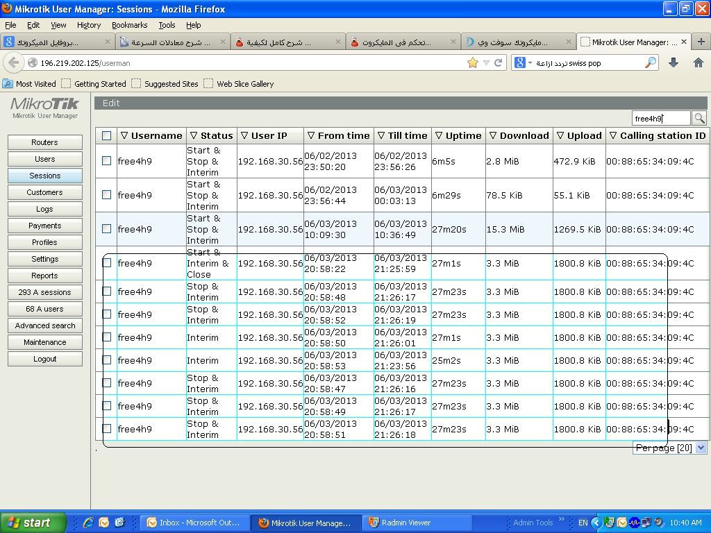

Recently i bought CCR-1016 router board, where i have the problem of “error simultaneous session limit reached” appeared for a lot of our clients, i tried to find out the way to solve this but i cant, the only thing that appear not logic that the session for the same user was repeated or replicated for 8 sessions at the same time on the user manager session screen. how could this happen?

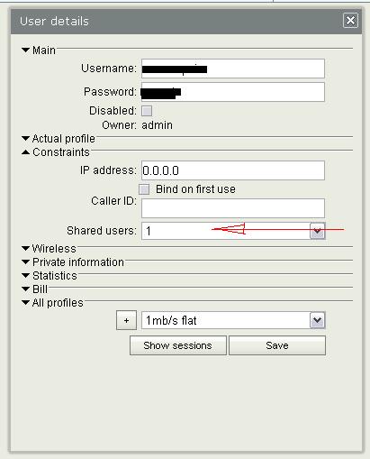

Check this.
Also,
under “Profiles” you can to define “Shared users:”.

but the main problem was in configuration of radius server and already it was solved

Log into your Mikrotik via Winbox.
IP>Hotspot>User Profile> Default User profile. Double click and open the default profile. The option “shared users” shouldn’t be configured.
IP>Hotspot>User Profile> Default User profile. Double click and open the default profile. The option “shared users” should be 1
ادخل لليوزر منجر وخلي عدد المسخدمين غير محدود بكل بروفايل فهمت
