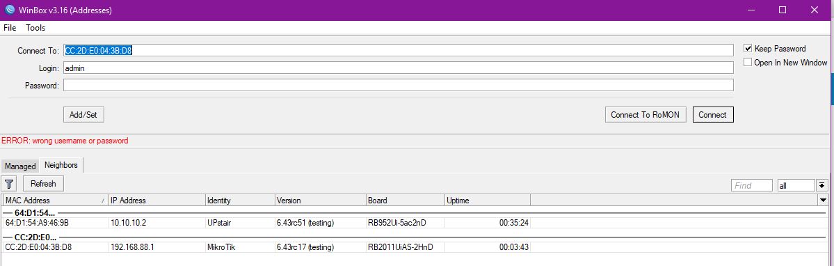

ERROR: wrong username or password
Router RB2011UiAS-2HnD after FULL reset in winbox when i try to connect via MAC address show wrong username or password??
as always default password is:
admin and “blank” as password
i cant understand what is wrong with router?
Anyone can help? please
for full reset i use router touch screen monitor Reset Configuration function with default password “1234”
Try to Netinstall.
The screenshot shows that you are trying to connect by MAC.
Try connecting by ip.
