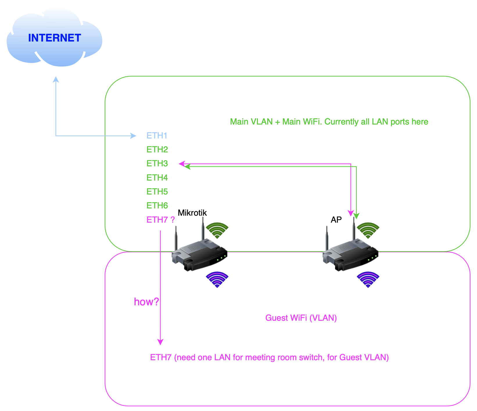

So i have working situation with isolated guest vlan (wifi). But there is a need for LAN cables in meeting rooms. What is the way to “attach” one of the lan ports to the guest vlan?
Please see schematics:

I love working with VLAN’s. In your case Corporate, Guest and Management (if required). Assuming you have MikroTik hardware (what hardware do you use?), this can be easily accomplished:
At the moment it’s still on the “hap ac2”, but we already made pre order for: L009UiGS-2HaxD-IN.
So currently i can setup this on “hap ac2”, later will migrate configuration to the new one 8 port device.

There are some examples and even configuration files. But i cannot upload configuration file, because this is not empty router. It have a lot of settings and customisations and i cannot loose them. So i need to do it somehow by my self. I found many examples, but all of them a little bit different. Could not find identical situation. As i understand i have to make somehow “Access port”? or no?
I already have 2nd DHCP pool, 2nd address list, and it is working fine with guest WiFi. But how do i attach one of the eth? ![]()
It’s up to you how to approach this. You could share your current config for better advice:
/export file=anynameyoulike
Remove serial and any private information (like public IP address).
Thank you, i’ve managed to do it!!!
This post: http://forum.mikrotik.com/t/using-routeros-to-vlan-your-network/126489/1
helped a lot!!
