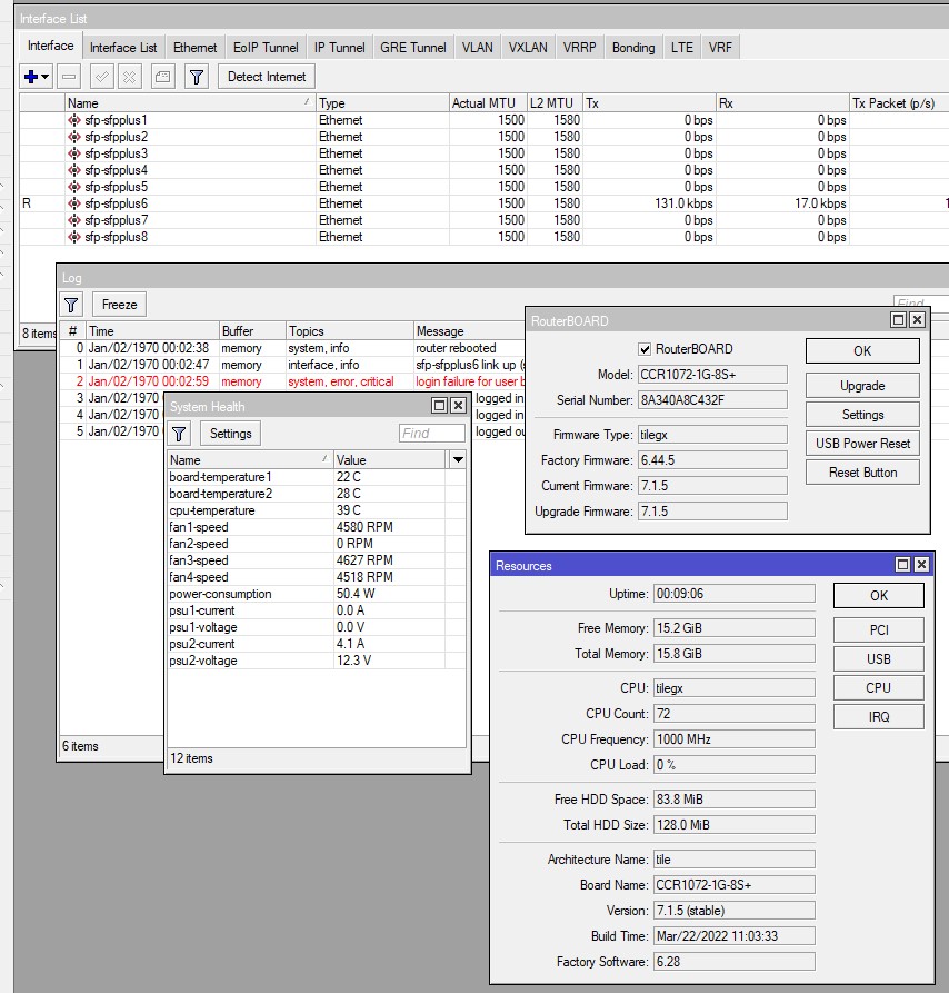

Hello, I´m recently have installed a brand new one CCR 1072 and note that ether1 interface does not shown at interface tab… so I´ve upgraded to 7.1.5 and still vanished… the port doesn´t work and many others like sfp+1 or sfp+3 work with problems…
Any ideas?
Thanks in advance

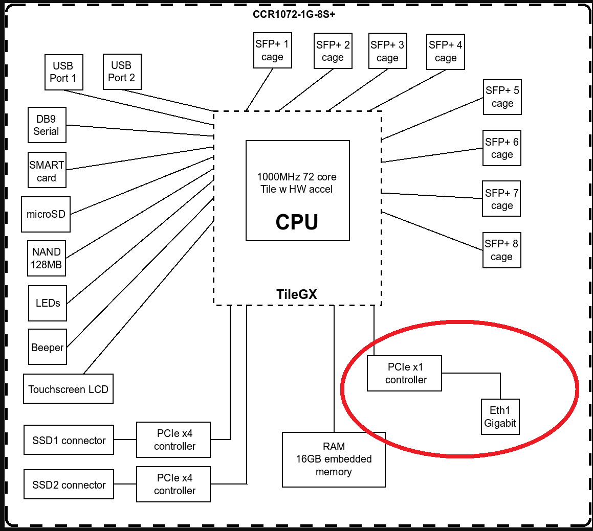

If ether1 is not present it is most likely a defect. It is via a pci-e controller attached to the Tilera. I would get a rma.

Hi! yes, have done that. And here is the response to command you suggested
[admin@MikroTik] /interface/ethernet> print
Flags: R - RUNNING
Columns: NAME, MTU, MAC-ADDRESS, ARP
NAME MTU MAC-ADDRESS ARP
0 R sfp-sfpplus1-GUAN 1500 74:4D:28:4A:A9:DA enabled
1 sfp-sfpplus2 1500 74:4D:28:4A:A9:DB enabled
2 sfp-sfpplus3 1500 74:4D:28:4A:A9:DC enabled
3 sfp-sfpplus4 1500 74:4D:28:4A:A9:DD enabled
4 sfp-sfpplus5 1500 74:4D:28:4A:A9:DE enabled
5 sfp-sfpplus6 1500 74:4D:28:4A:A9:DF enabled
6 sfp-sfpplus7 1500 74:4D:28:4A:A9:E0 enabled
7 sfp-sfpplus8 1500 74:4D:28:4A:A9:E1 enabled

IMO , I suspect there may be a problem with the PCIe x1 controller ( circled in red in my image post here ).
Your options are:
  • Continue to use it as-is ( if you don’t need the ethernet ).
  • RMA it to where you purchased it ( if it is still under warranty ).
  • Put it in a refrigerator for 15 minutes ( not the freezer ), If the Ethernet port shows up when the board is cold , then it might be the PCIe x1 controller is starting to go out , or a hair-line cold solder joint near the PCIe X1 controller.
  • Use a strong magnifying glass and follow all of the circuit board board traces from the Ethernet connector to the PCIe X1 controller chip and examine the traces to/from the PCIe X1 controller chip.
Note - most networking problems are at the physical L1 level. Thus look of loose solder connections and hair-line-thin shorts and look for any rounded ( blown capacitors ).
FYI - Many years ago ( late 1970s ) , I was a electronics board repair tech - so this info might help …
If you resolve the problem , please post what you did to resolve it.
