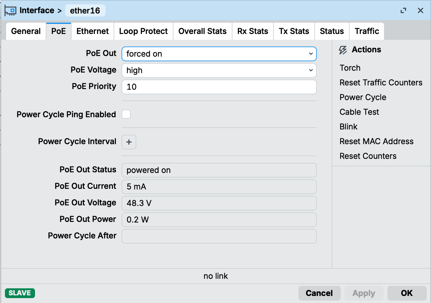

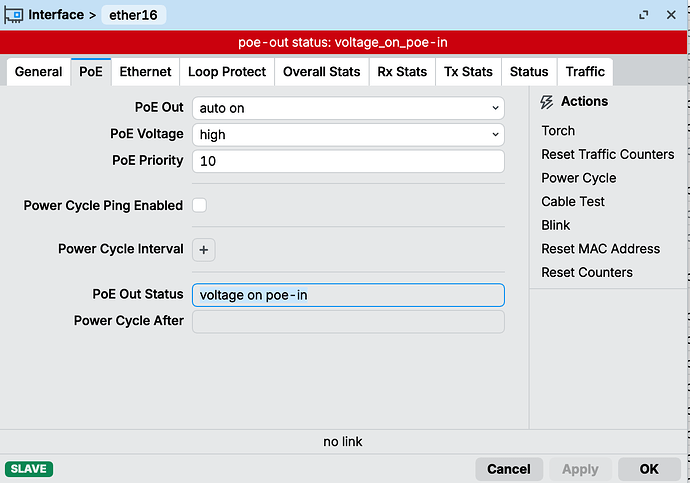

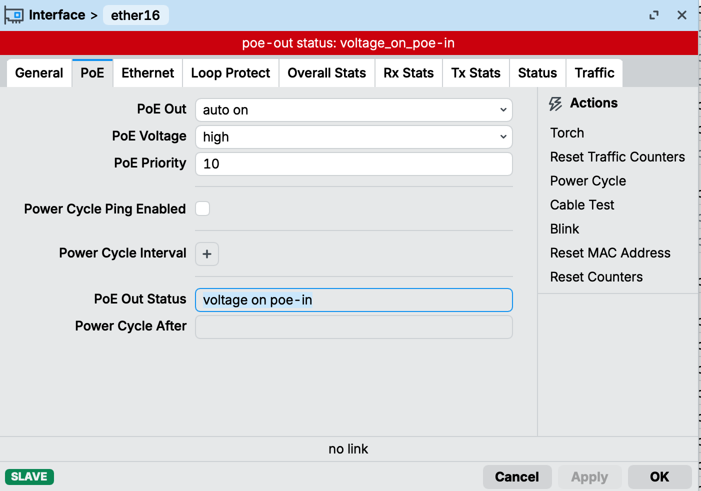

I am seeing the same / similar error on a Netpower 16P (CRS318-16P-2S+) on a single port, with nothing connected to the port.
No other ports are throwing this error, and PoE-out seems to work fine otherwise (although I have not tried using this particular port, but I believe it worked in the past.)The switch is being powered through the “high-voltage” (30-57V) DC barrel jack.
Weirdly, if I set PoE out to “forced on,” I see a small amount of current draw from the empty / unused port:
There is physically nothing in ether16 at all, not even a dangling cable. The pins in the port look fine, as well.
