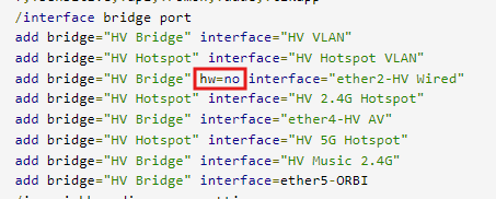

add bridge="HV Bridge" interface="HV VLAN"
add bridge="HV Hotspot" interface="HV Hotspot VLAN"
add bridge="HV Bridge" hw=no interface="ether2-HV Wired"
add bridge="HV Hotspot" interface="HV 2.4G Hotspot"
add bridge="HV Bridge" interface="ether4-HV AV"
add bridge="HV Hotspot" interface="HV 5G Hotspot"
add bridge="HV Bridge" interface="HV Music 2.4G"
add bridge="HV Bridge" interface=ether5-ORBI

Under /interface bridge port your config is currently explicitly turning off hardware offloading for ether2 (and only that port). Is there a reason for that? If not, try to re-enable hardware offloading.

The hw=no on ether2 isn’t something I had spotted (so thank you, extra eyes always help) but is now on and I am hoping was the culprit. It wasn’t off intentionally and I am not sure how it got turned off. I will try things again on Sunday. Hopefully this is the fix.
Well, from bad to worse.
Changing the hw-offload apparently made no difference, 80M upload, 5M download. Comparing this to 160M up, 280M down on wireless.
