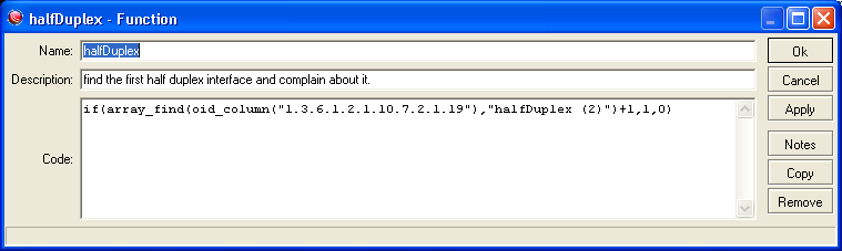

Here is a function that returns 1 on the first interface that is half duplex.
if(array_find(oid_column(“1.3.6.1.2.1.10.7.2.1.19”),“halfDuplex (2)”)+1,1,0)
You can put that function directly on a label [halfDuplex()]
If you do put it on a label maybe you would change it to something like this.
if(array_find(oid_column(“1.3.6.1.2.1.10.7.2.1.19”),“halfDuplex (2)”)+1,“Half Duplex interface found”,“”)

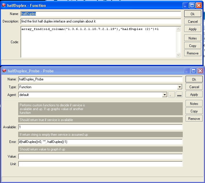

Here is a probe.
The thing is you can use the array element to help determine which interface it is. So change the function so it just returns the array element and then you will get a whole number for the interface that is half duplex.
Function
Probe
if(halfDuplex()=0, “”, halfDuplex()-1)
