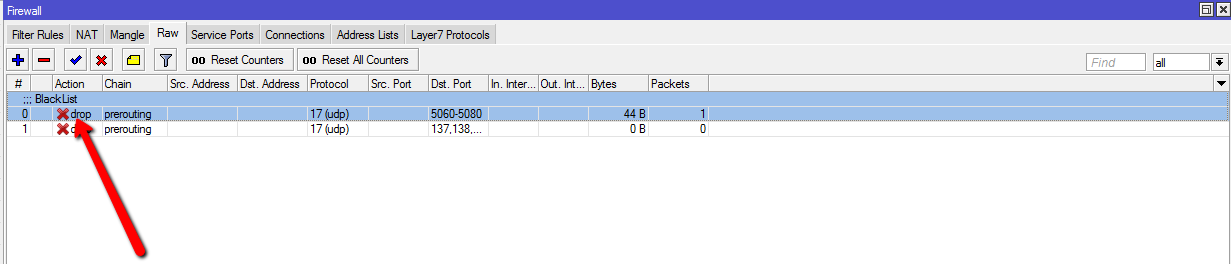

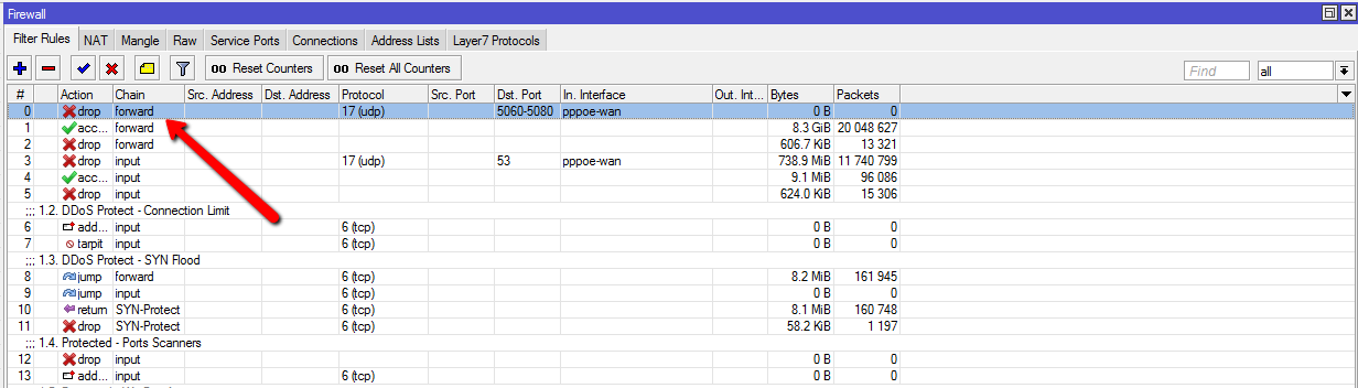

I tried all variants but rule is not working. I have task from my chief - block all connections on ports 5060-5080 from abroad. I tried to block one subnet 37.0.0.0 but rule not working :frowning:
Here are my firewall settings

Screenshots don’t show complete story and it’s hard to tell why rules are not working for you.
It’d be much easier to comment if you posted output of command /ip firewall export … run it in command window, copy contents and post it here in [ code ] environment (you may want to obfuscate your public IP address if it’s used in any of rules).
Rule actually seams working fine as u can see one block in raw filter, its not showing in IP firewall because RAW already filtered it.

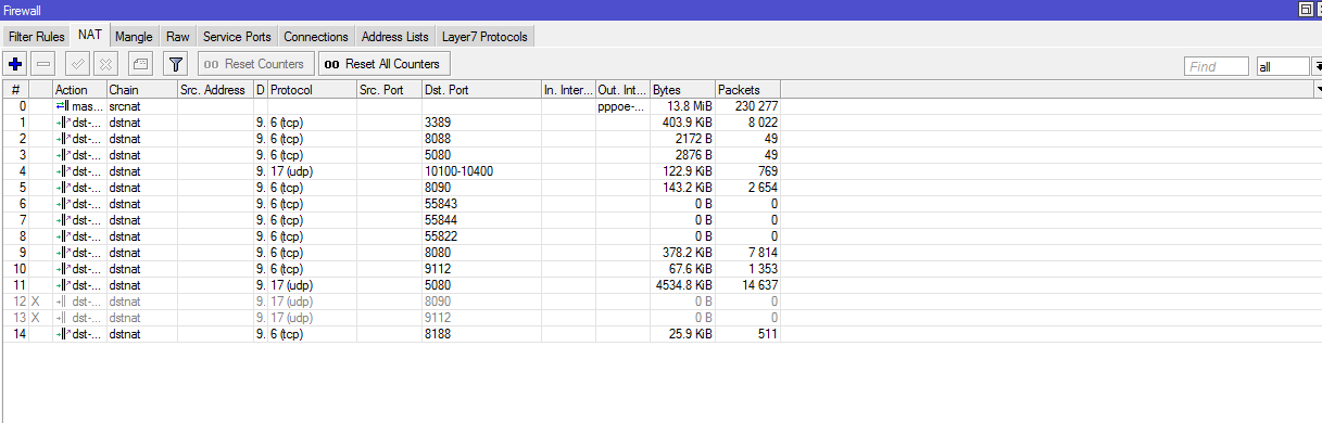

The one thing I noticed from the getgo is that you are blocking 5080 but you want incoming 5080 to be dstnatted, which may prove difficult to setup.

there are a number of dst-nat rulest (a.k.a. ports forwarded) where dst-address is used. If you only have single public address, you can use in-interface=pppoe-wan instead of using dst-address=95.a.b.c to eliminate setting public IP address there. You only have to use IP address there if you want to perform hair-pin NAT, but for that you’d have to masquerade connections towards LAN servers as well (you don’t have that currently).
