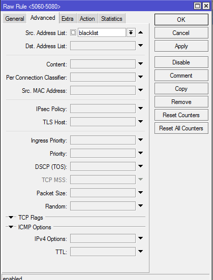

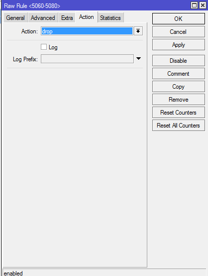

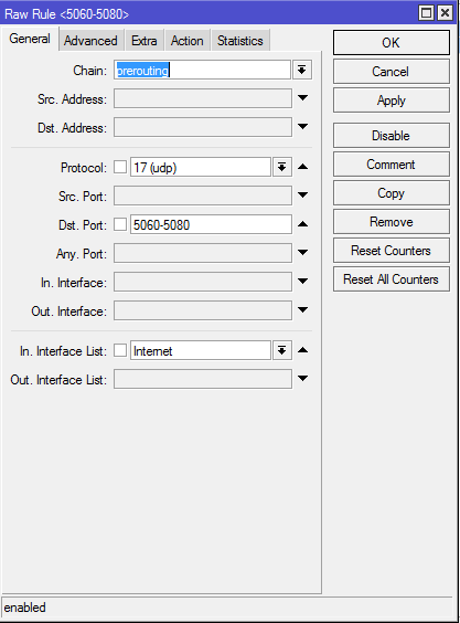

Hi.
I have a problem with RAW rule.
In the Mikrotik I mapping port 5060 on UDP protocol and I add rule on the RAW to drop all connection on this port from blacklist. But this rule not working and users try to connent throuth this port to my PhoneStation.
What am I doing wrong.
