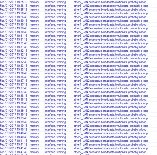

excessive broadcast/multicast,probably a loop
Dear All,
Seeking your help. In my mikrotik CCR1009-8g i have used ethernet6 and 7 for my LAN. Recently i’m receiving huge error. But couldn’t find any solution. Seeking your help. SNAPSHOT is attached here.

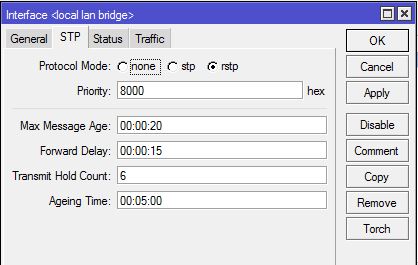

Make sure your Bridges have (r)stp enabled.
You’re probably plugged into an unconfigured switch thus creating a loop as all ports are in the same layer 2 network.

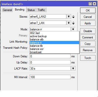

  1. No VLAN.
  2. How to configure rSTP.
    3.Using bond
  1. I’m not using any bridge here. Using bond. actually i’m not a network guy.
From what I’m seeing, you have two VLANs / Bridges (ether6_LAN2, ether7_LAN) in a bond??!?! That can’t be good! :open_mouth:
