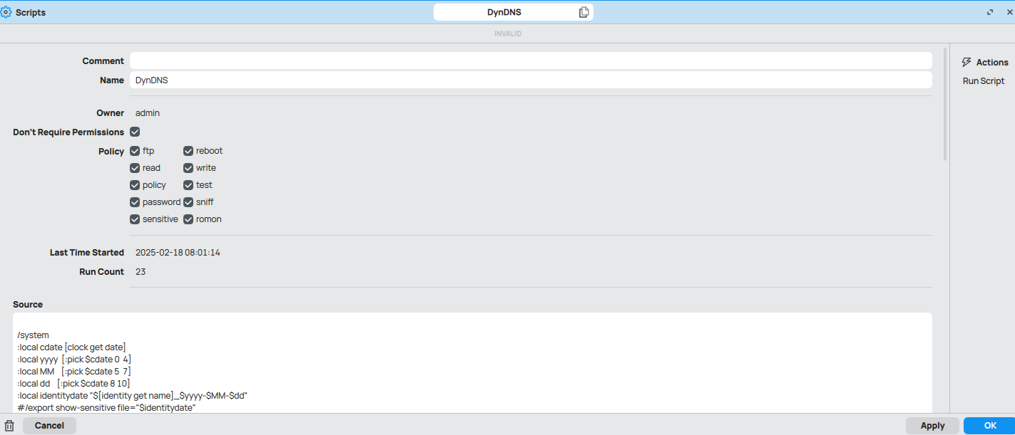

So I started to write the following:
I use Winbox often instead of the CLI, where it shows this:
The “Don’t Require Permissions” checkbox is checked. Doesn’t that mean “dont-require-permissions=yes”
And yet, the export does indeed show “dont-require-permissions=no”
when I realized I have 2 different scripts (see if you can tell the difference):
dyndns
DynDNS
Ugh – I think the system (but more likely I) was confusing them somewhere along the way.
Troubleshooting now…will summarize my findings…

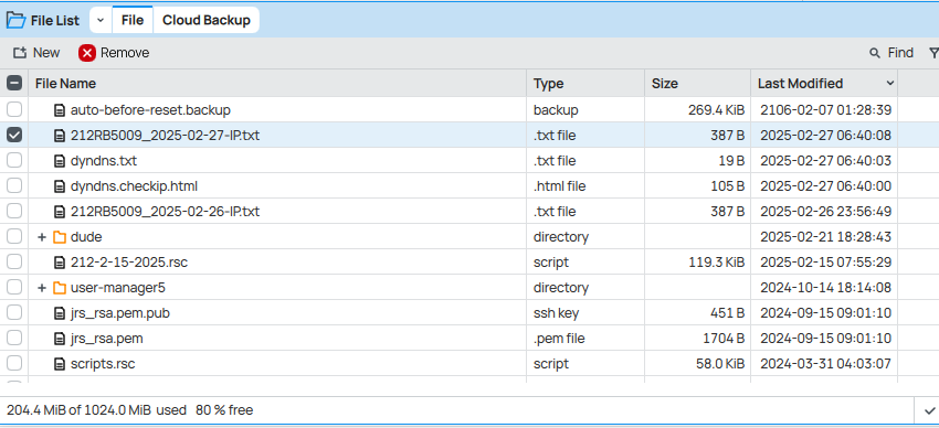

Is there any reason why the following line would cause an error (possibly only when called by scheduler):
/file remove "$identitydate-IP.txt"
Files look like this:
The file:
212RB5009_2025-02-27-IP.txt
was created with this code (in the script):
/system
:local cdate [clock get date]
:local yyyy  [:pick $cdate 0  4]
:local MM    [:pick $cdate 5  7]
:local dd    [:pick $cdate 8 10]
:local identitydate "$[identity get name]_$yyyy-$MM-$dd"
Followed by the following inside the “if” used to determine is a dyndns update is required:
                                           /ip/address print file="$identitydate-IP"
remove want one array of one or more IDs as parameter
/file remove [find where name="$identitydate-IP.txt"]
no matter if on terminal this or that work or not.
Do I understand correctly that "remove" wants an ID number, and not a quoted file name?
I have made the change and will report back.
