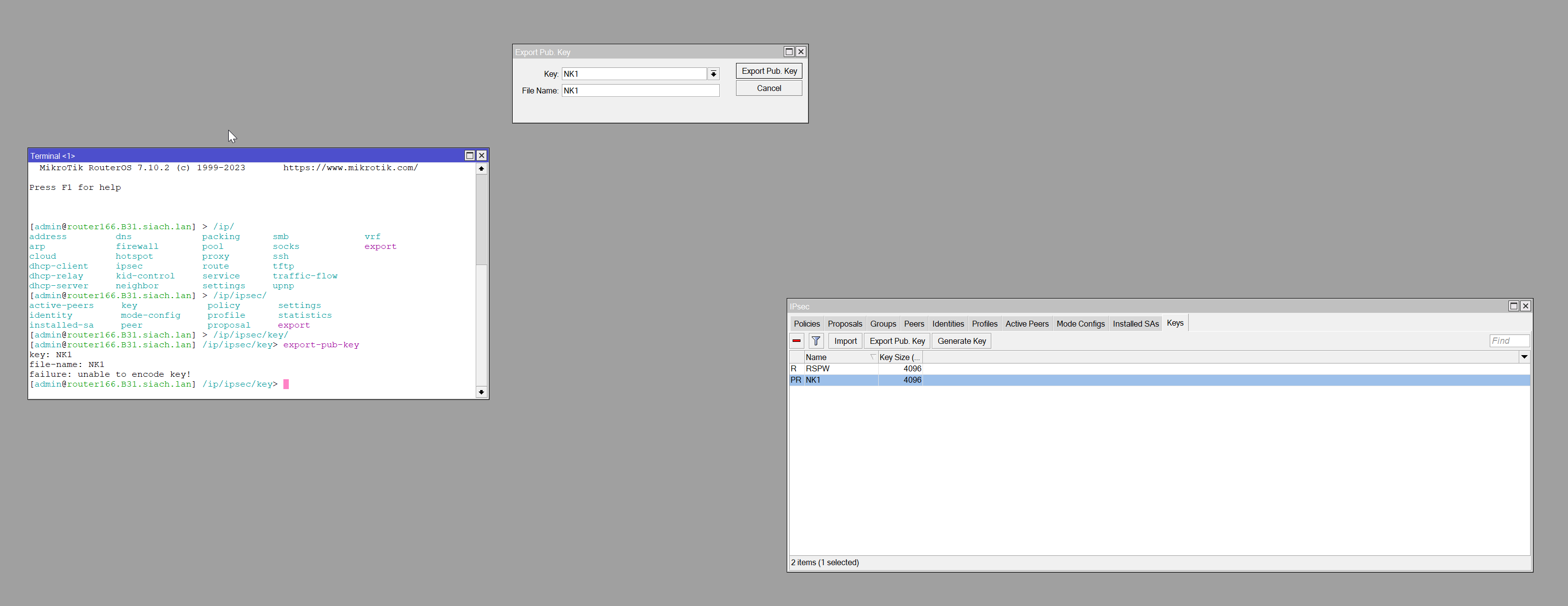

I am trying to export a public IPSEC key via /ip/ipsec/key/export-pub-key but I get the following message:
failure: unable to encode key!
Thanks in advance.

Hi. I am running into the same error. Just wondering if you have found the solution? Thanks.
I suspect this may have been broken in “ipsec - refactor public key authentication;” in 7.10. As a workaround you can generate the key elsewhere and copy it to the routeros box.
Just to update. I reported this issue to Mikrotik support. They came back with an 7.12 alpha build which includes the fix to this issue. So I suppose this will be resolved at least in the official 7.12 release (or next update).
HTH.

Confirmed fixed in the recent update 7.11
http://forum.mikrotik.com/t/v7-11-2-stable-is-released/168778/1
*) ipsec - fixed public key export (introduced in v7.10);
