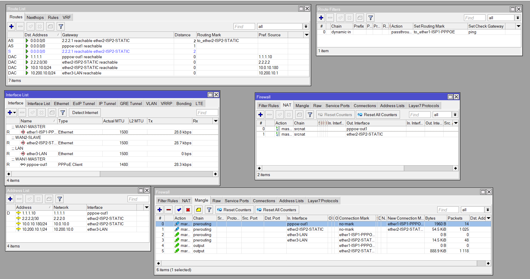

This is my test configuration on a virtual machine. He is only there so that you can diagnose the problem. I followed the guide from https://khmernetworkings.blogspot.com/p/mikrotik-fail.html

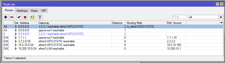

From what I see in the routing table 0.0.0.0/0 gw pppoe-out1 is reachable but there is nothing in the Routing Mark column (it should be to_ether1-ISP1-PPPOE)
Addresses 10.0.10.0/24, this is only the connection address for tests

I had a problem with this test setup. I entered the wrong distance for ISP2. I changed it but I can’t change the photo in the post
