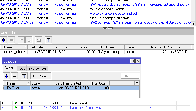

Under 6.25 the script running on a 15 second schedule interval does fail over to ISP2 but it then fails to reset the distance for ISP1 once its allowed to ping the checking ip (8.8.8.8 google dns in this case)
http://wiki.mikrotik.com/wiki/Failover_Scripting
I’ve tried FailOver Script but its not working correctly on 6.25. As you can see from the logs it does fail over to ISP2, but then when ISP1 is allowed to ping (8.8.8.:sunglasses: it says ISP2 instead of ISP1 and the static route for ether1-gateway isn’t restored back to 1. Any ideas? I’m using a firewall drop rule to drop 8.8.8.8 out ether1-gateway to trigger the script to believe there is a failure. Original distance was 1 for ether1-gateway and it increases to 3 but the script somehow messes up and tries to change ISP2 distance back which 2-2 wouldn’t work and thus the value stays 2 for ISP2. Script was copied/pasted and only gateway values, interface names and ip to ping was adjusted.
Unfortunately after extensive testing I’ve been unable to make this script work properly to fail back over to ISP1. I’ve emailed the original creator of the script but haven’t been able to get a response. If anyone has had success getting this script to work I’d appreciate some feedback/comment. This is under RouterOS v6.27. The script was originally written when 5.x was the latest. I’m using a CRS125-24G-1S-2HnD-IN unit with the wireless setup as the ISP2 client using a Mobile HotSpot. It can get it to fail over to ISP2, but can’t get it to properly fail back when ISP1 is available again. I’m using firewall rules to block the dns query on ISP1 to trigger the failover.
