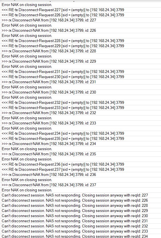

With the V5 User Manager (ROS 7) and ROS6 routers there is a similar problem, with EAP wifi authentication
User Manager closes the session, as it detects the router (NAS) is not responding at a certain point in time.
User manager closes the session, but the NAS (AP) does not.
Then accounting packets are sent at the set interval but ignored as the session does not exist in User Manager.
User Manager sends a request (port 3799) to close that session on the NAS (AP)
But gets back a NAK for this closure request. (“empty SSID” as potential reason?)
And then User Manager keeps repeating this all the time.
Ending with many many sessions with accounting failure in the router profile incrmenting, and closure reason “NAS rebooted”
Workaround so far, is disable EAP accounting in the security profile in the AP, what will close all the sessions in the NAS (AP), and tell User Manager.
Security profile in the wireless setup, it’s not in the RADIUS setting.
Accounting packets keep coming
As User Manager claims the NAS (router/AP) rebooted, but the NAS did not reboot. The wifi sessions are still active.

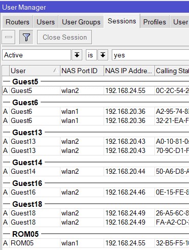

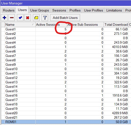

Another problem with counting active sessions. The User Manager software for extracting the active user sessions finds and counts all users that contains the checked user name.
If you check lets say “Guest1” , then sessions of “Guest1xxxx” , with xxxx any string, are counted and combined.
Clearly seen when Guest10,Guest11,Guest12 … active , not Guest1
With User Manager limiting the allowed active sessions that might be a problem for Guest1.
Database search string might be something like “Guest1*” , not “Guest1” or the “is operator” is replaced with “contains”.
versus
but 5 and not 6 , so might be something else
Undeletable Phantom sessions seem to be there when the “Active Sub Session” counter is lower than the “Active Session” counter.
Is “Active Sub Session” counter the real active session counter?
