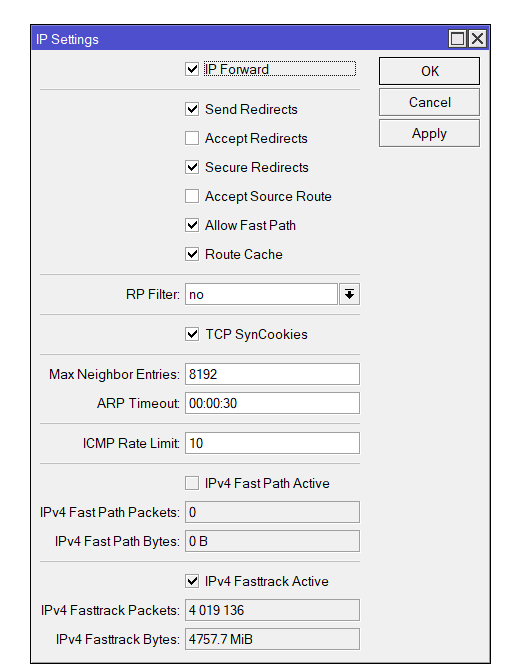

Fast-Track not working - was: How to test bandwidth properly
Hi all,
what is the correct way to test the inter-vlan-routing capacity/bandwidth properly?
At the moment i have a hypervisor with a 10G-Trunk with 4 VLANS, and a VM in each VLAN with a router-on-stick RB5009 who does the routing between the vlans.
For tests i have disabled all Firewall Rules.
VM_VLAN10+VM_VLAN20–>vSwitch–>Trunk-to-CRS309–>Trunk-to-RB5009
But even then i just get the following results instead of the advertised which should be around 7479.1 Mbit/s
Greetings
mg

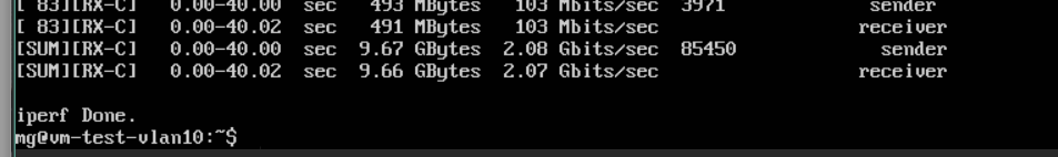

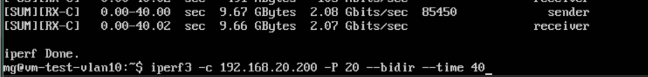

  2. Test-Parameters
    Can you also Post your iPerf-Test parameter
P.S:
The 7479.1 Mbit/s only works for Transfer of 1518 byte
I recommend using 2557.1 Mbps as a real world Reference Value.
iperf:
iperf3 -c <ip> -P 2 --bidir

Thx for the info.
The WIki states:
/ip firewall filter add chain=forward action=fasttrack-connection connection-state=established,related
/ip firewall filter add chain=forward action=accept connection-state=established,related
But even if i do that, or marked the connection with a mangle rule and let the fasttrack rule work with the connection marked i dont get Throughput greater than 1GBit/s.
So please enlighten me in my ignorance :smiley:

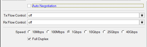

The Adapter (SFP+/Ethernet) may be the problem.
Auto-Negotiation doesn`t always work.
You may want to check what speed they negotiate or set it manually .

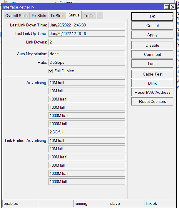

Ok, but how i can i force the Link-Speed to 2.5GBit/s? If i disable “Auto Negotiation” is see only this:
2022-01-20 14_13_02-admin@192.168.2.224 (crs309) - WinBox (64bit) v6.49.2 on CRS309-1G-8S+ (arm).png
I think your Link is 1000Mbits.
In the Picture you posted, you can see the Parameter “Link Partner Advertising”
And 2.5Gbits is missing
I looked a bit in the Forum, mikrotik doesn`t have manual 2.5 and 5Gbits at the moment.
You can play with Auto-Negotiate and Advertising on both device
Until you get maybe get 2.5Gbits :frowning:
If you have a SFP+ to SFP+ Cable lying around,the easy Solution, is to try connecting the switch and Router via 10Gbits.
Did that a moment ago. :smiley:
…and et voila 2.x GBit/s.
Thats is the Firewall Config at the moment. Did i miss anything?
The throughput with fasttrack or fasttrack disabled is almost the same. And i see the counters from fasttrack and my normal rules increase.

I see that FastTrack is enabled but not FastPath, maybe thats why the FastTrack-Rule is counting the traffic.
2022-01-21 12_37_00-admin@192.168.2.1 (rb5009) - WinBox (64bit) v7.1.1 on RB5009UG+S+ (arm64).png
@ConnyMercier
I dont get FastPath enabled, only FastTrack… do you have an idea?

Would this explain it?
While FastPath and FastTrack both are enabled on the device only one can be active at a time.
Found in the firewall section at https://help.mikrotik.com/docs/display/ROS/Basic+Concepts
I see the same thing on my 5009
Sorry, I sometimes obsess. https://help.mikrotik.com/docs/display/ROS/Packet+Flow+in+RouterOS also explains a lot about fast path and fast track. Basically fast path works if certain conditions are met, including not using fast track. fast track is noted to basically be fast path + connections tracking. It notes that
marking packets that belong to fast-tracked connection will be sent fast-path way.
I am going to put my chair in here for a while and listen/look closly, as I am in the exact same thing here, with a RB4011 on v7.1.1 (CRS309 on 6.49.2)
I think it has something todo with this: http://forum.mikrotik.com/t/v7-2rc2-and-v7-2rc3-is-released/155369/1
*) bridge - added fast-path and inter-VLAN routing FastTrack support when vlan-filtering is enabled;
So maybe it isnt working in 7.1 atm.
