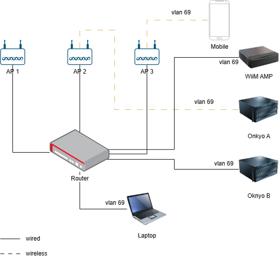

In addition, see my lan setup.
I have 3 audio devices, with Spotify service built-in. All 3 devices apears on the list of available devices in Spotify but I am unable to connect with them from any device (mobile, laptop). This happens when fasttrack is enabled. Everything starts to work on Spotify when I disable fasttrack.
mt.rsc (8.35 KB)
Huh. That’s…really strange.
The forwarding firewall and NAT parts of your config seem pretty basic. (In fact, I think that 3rd rule, the “accept” for “connection-state=established”, is probably not really doing anything for you, since after it there are no further “chain=forward” filter rules that would try to drop anything, and the default behavior is “accept” anyway. It’s harmless to keep it in place for just in case you ever do add some forwarding drop rules later but don’t want to forget about adding that, though I would probably change it to “connection-state=established,related” so it catches all of the same traffic that the “action=fasttrack-connection” rule above it does.)
From my reading up on Spotify Connect, you’re basically remote-controlling one Spotify client from another, and the client being controlled just talks to Spotify’s servers directly to fetch the music it has been instructed to play back (so this isn’t working anything like, say, Apple Airplay, where the audio stream is being relayed through the remote control device). The remote control part can happen across the internet, in which case I could see how NAT might come into play (the client you want to control is going to have to punch a hole in the NAT somehow so that it can await “unsolicited” remote-control commands to come to it from the internet)…but if I am understanding your diagram correctly, you are trying to control your receivers from either your phone or your laptop, BOTH of which are on the same VLAN that the receivers are! And my understanding is that when the player and the remote control are both on the same ethernet broadcast domain, the two clients talk to each other directly over the LAN, not via the internet (finding each other through Zeroconf / mDNS)!
Given that, I’m having trouble understanding how Fasttrack’s got anything to do with anything here. Though clearly it does, or you wouldn’t be posting this. It does mean, though, that we are likely missing pieces of the picture.
Can you not see the receivers at all in your device list on your phone or PC when this problem is occurring? Or can you see them, but when you try to instruct them to play, they don’t seem to work? From either your phone or PC, do you notice any problem with accessing the Spotify service itself (playing back music directly on the phone/PC) while Fasttrack is enabled?
Hi Nathan,
All 3 audio devices appear on the list of available devices on Spotify apps (on desktop app on laptop and mobile app on phone). And yes, all receivers are part of the same network/vlan. In terms of device discovery on Spotify apps, all is fine. What I’m unable to do is to stream a music from a controller (Pc/Phone) to another audio device. “Connecting…” seems never ending.
However, your reply provoked me to do further testing (mDNS). Interesting enough, there is one device I can stream a music to from all controllers. It is the one connected via WiFi (Onkyo A). I can play the music on this receiver from my laptop and/or phone. Even when fasttrack is enabled! wtf?
Surprisingly, music streaming Laptop ↔ Onkyo B (both wired, part of the same VLAN) does not work with FT enabled, but Eth/Wifi works fine with FT enabled.
That was my understanding too, ather this finding I’m totally confused.

Hi sirbryan,
Porta eth7, eth17, eth22 and eth24 are the ports to which Access Points are connected to. Each of AP broadcast 3 different networks. Those networks refer to vlan config on CRS125 (vlan 59,69 and 79). So those ports are trunks.

Otherwise, how would APs know which network they should get an IP from? In my scenario, all IPs are getting IP from 10.69.0.0/24 network, the same network where home equipments are connected to. That is audio devices, laptops, phones etc.
If that would be the reason, then how to explain the fact that I can stream a music to one particular audio device (connected via AP)? And I’m not trying to be pretend I’m clever. I’m just trying to understand what is going on.
In reference to what Nathan said before, the only thing that came to my mind was mDNS config. I reviewed the config of APs (on unifi controller) and found out that mDNS was enabled for vlan69. Then I thought it makes sense and this could be the reason why streaming to Onkyo A that is connected via WiFi works fine. But then I switched this feature off for vlan69 and the streaming was not interrupted. Then I got back to square one, where I don’t know what is going on.

Only a guess, but this sounds to me suspiciously like an MTU issue. Are you sure you have L2MTU configured properly? It’s quite usual for the normal (slow) path to fragment packets, but for fast path to simply drop oversized packets.

Is the AP doing some kind of multicast to unicast translation? I know Ubiquiti can do this.
Are the APs’ configs identical. Your diagram shows your phone connecting to AP3 and the Onkyo to AP 2. Does it work if you’re on the same AP as the stereo system, or on a separate AP, or both?
My second theory is the AP is acting as the switch/bridge between your phone and the receiver, so it’s bypassing the router altogether.
Also, in the Bridge/Ports section, does the switch show an H next to all the ports?
Hi sirbryan,
I ckecked Multicast to unicast translation options. Indeed, such option is available on the controller. Regardless to its state (ON/OFF), the result is/was the same.
APs config is the same. Everything is done via controller (Network 9.1.120). It was my simplicity. Of course, clients are jumping from one AP to another, depending on the signal strength. When I did the recent test, my phone was connected to one AP, and Onkyo A (that works fine) was connected to different AP. When I was doing some testing the other day, my phone was connected to the same AP as Onkyo A and it was working fine as well. So regardless to which AP clients are connected to, streaming to one particular audio device works OK.
Interesting. Let me do some further testing around this. I will disable WiFi completely on my laptop, connect with VLAN69 by ethernet port and try to stream music to Onkyo A.
And yes, Hard offloading is enabled on all ports.
Ok, I disabled wifi card on my laptop. Ethernet connectivity only.
PC IP: 10.69.0.248, eth12
Onkyo A: 10.69.0.9, connected via AP with 10.69.0.40
Onkyo B: 10.69.0.13, eth2
WiiM AMP: 10.69.0.12, eth4
Result: Streaming possible from PC to Onkyo A only. Spotify client refuses to connect with Wiim and Onkyo B ← with fasttrack enabled.
Just after I disable fasttrack, streaming works fine to all devices.
