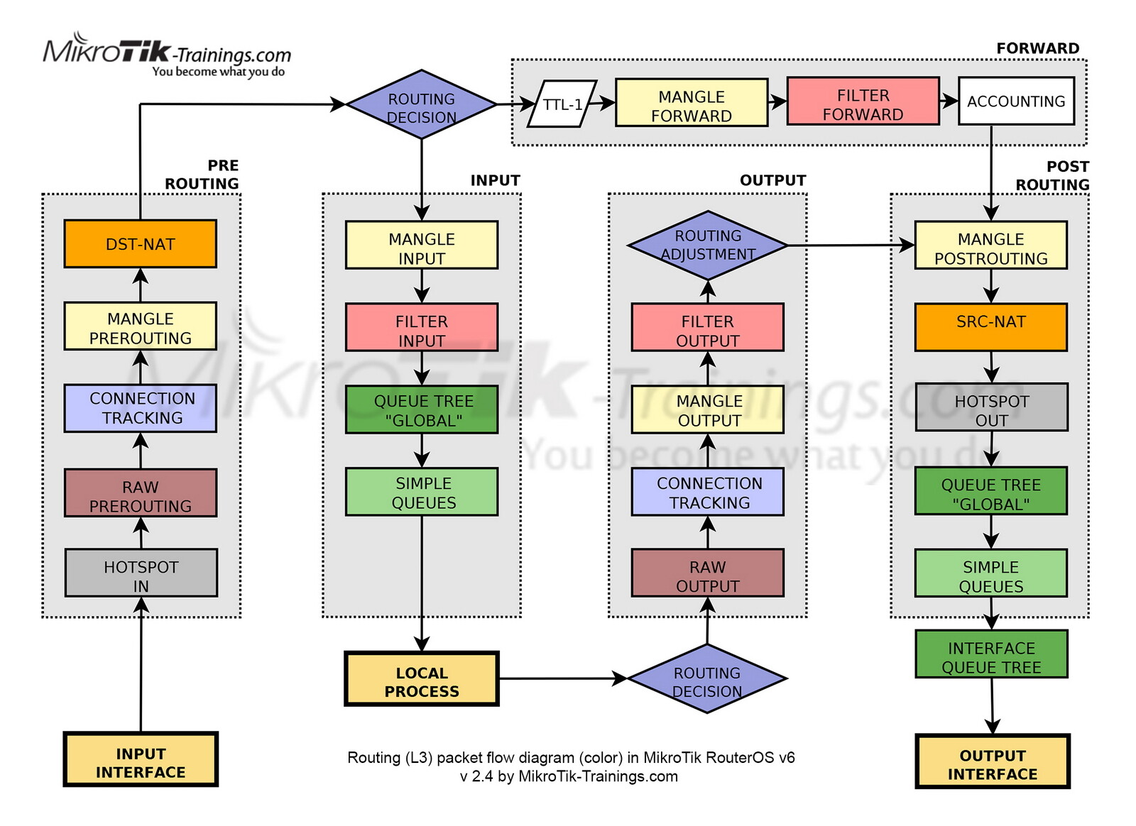

The difference is in the position of marking.
Look at the packet flow diagram, I attached.
Fast tracking in prerouting chain of mangling occures sooner than input chain of filter or forward so I think that prevents some unnecessary process.

Description of packet flow in new help page mentions briefly how fast track fits in packet flow. Text mentions that fast tracked packets skip connection tracking while graphics indicates some logic inside connection tracking parallelogram.
In any case, packets only enter prerouting chain but seemingly exit it before hitting mangle prerouting. And they definitely don’t enter forward (or input) chains. So they bypass all mangle and firewall (both raw and filter).
