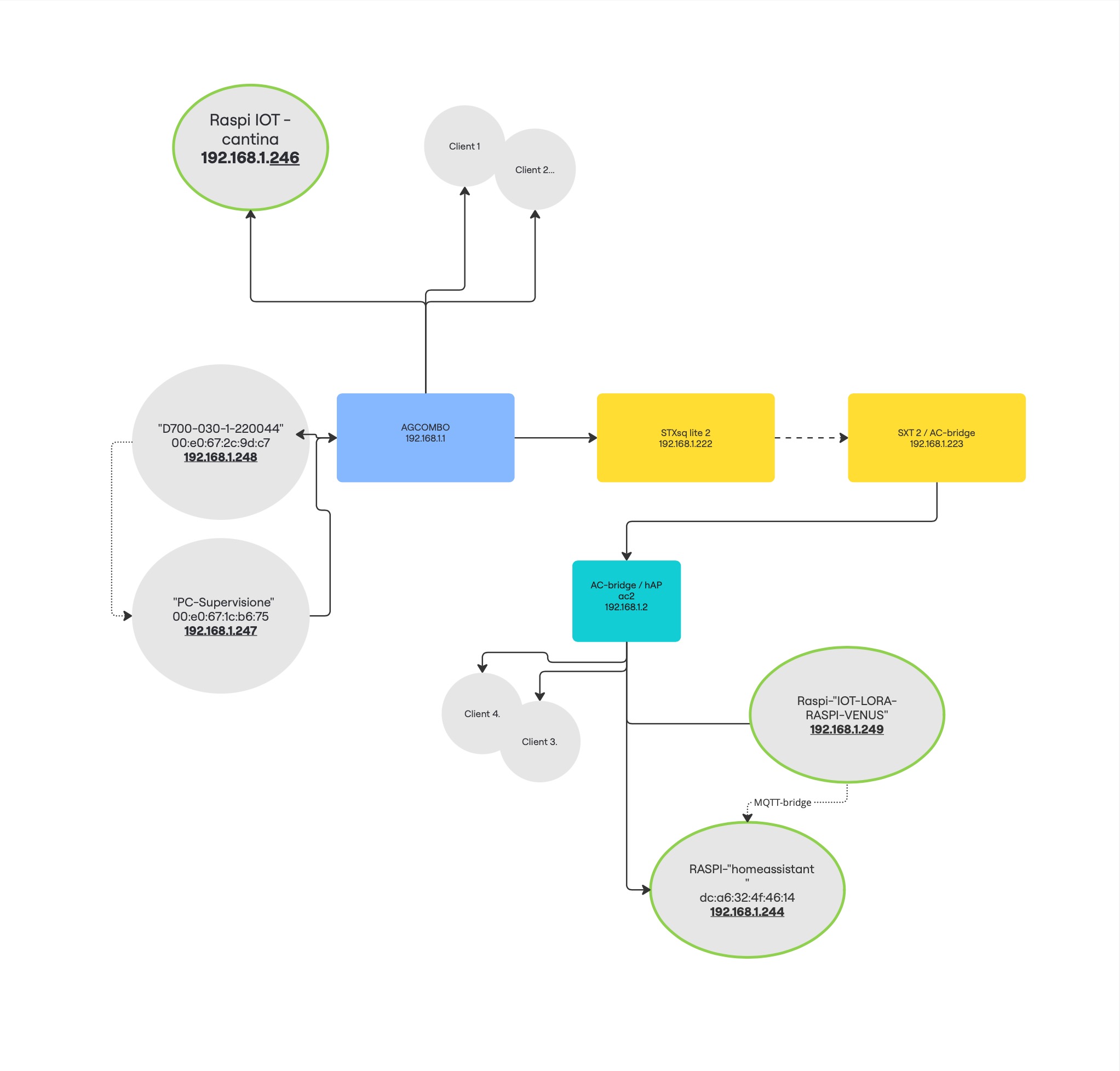

Here it’s a draft:
             Garage 2 (SXT 2)
   (Direct line of sight) (Direct line of sight)
  Main Home 1               Other Home 3 (SXTsq Lite2)
  (SXTsq Lite2)              (Connected via Building 2)
  to WWW.
Lastly, I think it may be more practical to assign static IPs to the APs, antennas, and router, provided that the firewall is configured to prevent direct access from other VLANs (except for authorized users). I assume that’s the direction I should take, correct?

Here the cofiugraiton of the PtMP, now connected to other router/modem with only one flat LAN.
SPOKEs ed. 1/same as ed. 2 exept that I will set an other IP on MNG subnet (ex. 192.168.99.XXX)

6.40 is ancient and can miss some functionality. I highly recommend you to upgrade to 6.49.17 (latest v6). I understand you may struggle but IMO this is essential. And yes, netinstall is a almost certainly a must (lack of space likely indicates remnants of unwanted config and/or unnecessary files on filesystem).
My reading of help document you linked doesn’t corroborate your theory about VLANs not being supported on spoke devices, manualy clearly shows them on AP and station side (in your PtMP setup you’ll have two stations and that’s the biggest difference).
Thank you, mkx. I may not have explained myself clearly—I was only concerned from the manual that it might not be possible to configure VLANs properly on the spokes with RouterOS 6.40.
I’ll try to update RouterOS with Netinstall somehow, but it’s quite challenging to do this from macOS. I’ll find a Windows PC if necessary to make it work.
Currently, I have a setup where my RB4011 is placed between the AGCOMBO (current ISP) and a PtoMP bridge (station bridge spoke to an AC bridge HUB), which is connected to an output of the RB4011.
I am adding VLANs only to a portion of the network at this time. I’ve set all ports of the hAP ac2 as trunks to carry all VLANs, with plans to optimize the VLAN table later.
Initially, I wanted to keep the IoT subnet on 192.168.1.0/24 to avoid changing IPs and routes of existing nodes, but I encountered conflicts. I then configured the subnet to 192.168.10.xxx. This allowed the RB4011 to reach the network, but the other devices are receiving an IP from the RB4011’s DHCP that differs from what I had manually assigned to them, causing access issues.
The problem is that while the RB4011 pings the AGCOMBO and Google correctly, it cannot reach the devices. These devices remain isolated, as if there were a physical barrier rather than a network connection. I suspect there may be issues with the routing. My intention was to set up a route for all nodes to point to the RB4011, but I’m not sure where the configuration is going wrong.
I’ve also tried configuring some forwarding rules between the RB4011 and AGCOMBO to allow access from the external environment during debugging, but these haven’t worked.
I would appreciate any advice on how to better configure this network to resolve the access and routing issues between the devices and the RB4011.

Two things which poke my eyes:
  1. disable detect-internet at least on PtMP devices … I’d disable it on all devices since you’re trying to configure things properly yourself.
    Function detect-internet may help in case when user connects WAN to a wrong ether port. But it also have potential to royally mess with your (painfully crafted) manual configuration.
  2. remove all routing and firewall stuff on hub device. As well as DHCP server etc. The idea is that PtMP appears as aan ethernet switch to connected devices (i.e. transparently connect parts of network, connected to ether1 ports of all 3 PtMP devices) … so your main router (RB4011) is supposed to perform those tasks - routing between VLANs and internet, firewalling, serving DHCP requests, etc.
    Adding a single default route on each of those devices via management IP address of main router has only one purpose: to allow PtMP devices comunicate with other subnets (including internet) - if FW on main touter allows. It has nothing to do with traffic only passing PtMP between ether ports (on edges of your PtMP “cloud”).
I have configured the first access point, which should tag incoming traffic.
If I have understood the concept correctly so far, between the RB4011 and the hAP ac2, it’s as if there is a single Ethernet connection (connected to eth5 on the router and eth1 on the AP). This is true thanks to the transparency of the Point-to-Multi-Point bridge that you have already explained to me in detail.
Once the RB4011 is introduced and all traffic directed to it is masked, it forwards the traffic to the ISP. So far, so good. The problem now lies with the hAP ac2, which does not tag VLAN10 for the hosts trying to connect to the vwlan-iot. In fact, running a Torch does not show any VLAN ID.
Additionally, wlan1 “baita_sp” is also active, which I use as untagged to manage communications. The goal is to gradually move the various devices to their respective VLANs over time.
Below is the configuration and attached the .rsc just in case:
