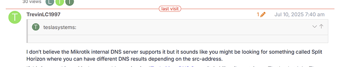

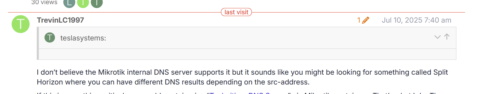

Emm, is it a forum bug or you just quoted an empty string?
