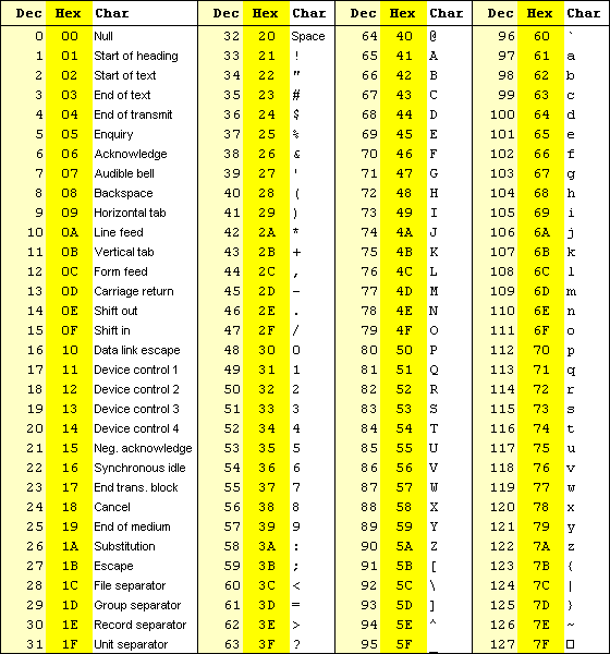

Try to add option 67 to the DHCP configuration, specify its contents in hex and add a trailing zero.
I’m not sure if this is the correct format of the string in RouterOS.
/ip dhcp-server option add code=67 name=pxe value=0x7078656c696e75782e3000
The following should work with ISC’s DHCP server.
dhcp-option=pxe,67,70:78:65:6c:69:6e:75:78:2e:30:00
