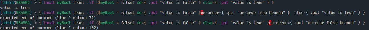

Should it provide
on-error={ ... }
for each do in if, if-else or the only one for the whole statement?
There is a separate :onerror handler, so I don’t see any sense in this.

It is simple you can use
:do {} on-error={} inside ‘if’ statement, However it does not require adding it besides because it will conflict with ‘else’ and ‘else-if’ (if it is added in the future) or prevent you from using them.
Could you please enlighten me both how the on-error for “if” should be used?
On the other hand, if the own “on-error” for each do is needed to be applied when sth goes wrong in the particular “if” branch. If there would be the only one whole statement catching “on-error” then you have to collect somehow what branch triggered the error … lets welcome try/catch statement :slight_smile:

you can use on-error inside if statement, as in the following example:
:if (<condition>) do={
    :do {
        <command>
    } on-error={
        <command>
} else={
    :do {
        <command>
    } on-error={
        <command>

Sidenote The :if is still a command (builtin function), so the on-error= is an argument to “if” command, just like else={}. The issue with “else-if” in OP is that is NOT an argument & new commands always need a newline or semi-colon (+whitespace). And 2nd, the stack be resolved if else-if was it’s own command — why the else-if is likely harder than some new :switch thing.

For the whole statement it would be like this:
:local x true
:onerror errMsg {
	:if ($x) do={
		:put "x is true"
	} else={
		:put "x is false"
} do={
	:put "Something is wrong, error: $errMsg"
@Moustafa :do {} on-error={} is deprecated (that’s what MikroTik support said) and may not work in some cases, avoid using it, use :onerror err {} do={} instead.
