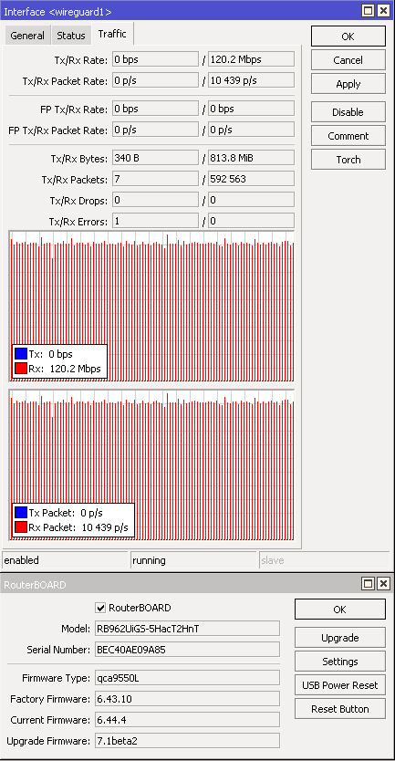

Installing a librespeed docker really quick on my server, I was able to get faster results and in the interface stats, it was even higher than the screenshot said. It’s a burst though and I’m not really sure how to configure this server to run longer tests. That said, they are pretty consistent on subsequent runs.
Also, so there’s no question about the underlying link quality, here’s the same test, but with not going through the tunnel.
