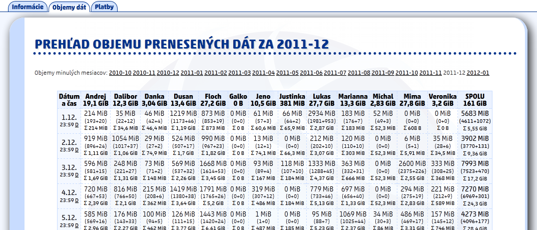

I’ve made a script which is saving data amounts of each user to logfile at midnight and then uploading the logfile to my web server using /tool fetch and FTP. (web server is generating tables, see attachment) The problem is that sometimes the logfile is transferred well and sometimes not - the transferred logfile is empty (zero length).
