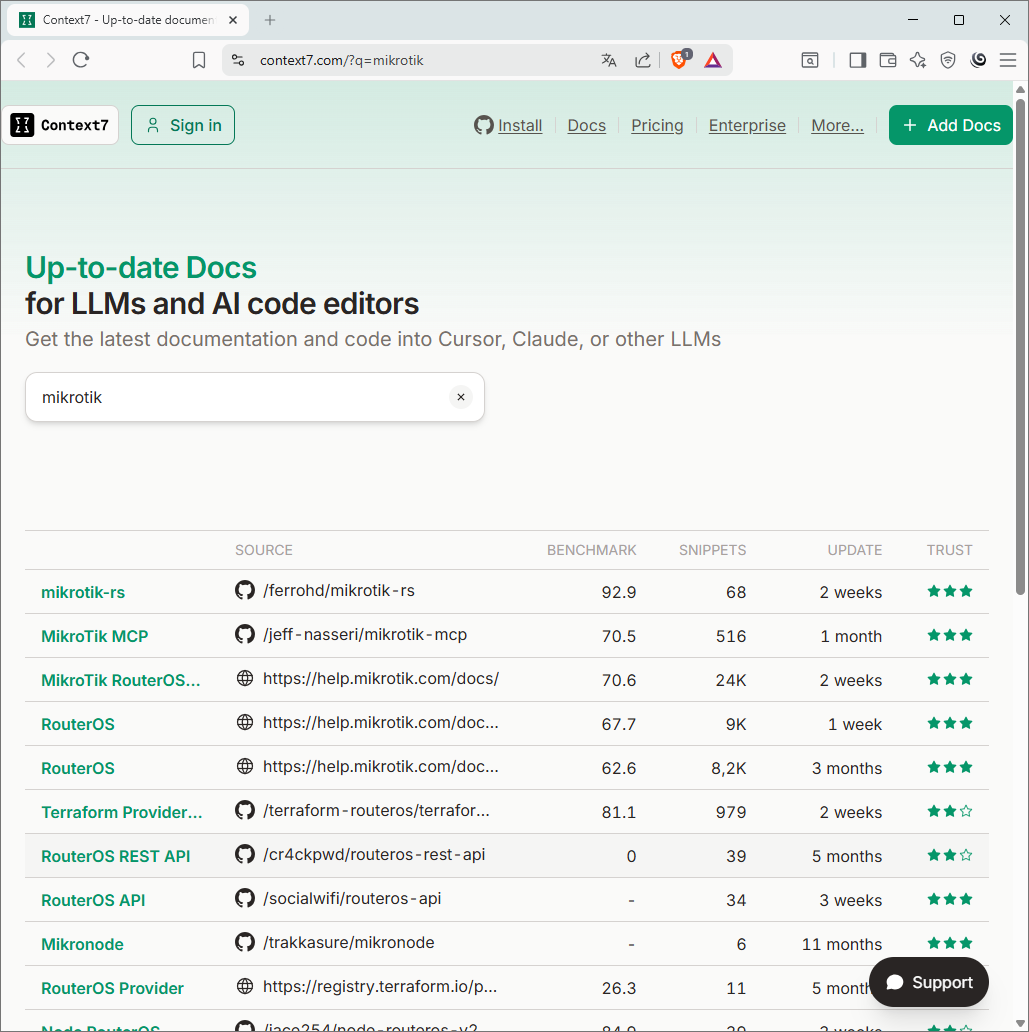

The LSP/MCP MikroTik Syntax created by our forum colleague should be input as the major reference for all IAs/LLMs.
There is something close to "robots.txt" that a companies can publish "official" information's like syntax reference?
It exists!
I didn't know about it...
