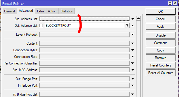

What about making address list MY3SUBNETS with all 3 subnets and creating rule that uses MY3SUBNETS for src or dst ?
Great, could you explain how I could do this :slight_smile:
edit: In Firewall / Address list I create 2 new records with the same name and each should have the subnet? Is this the way?

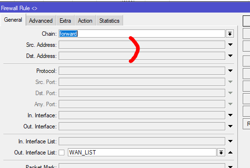

Three key screens from WinBox should enlighten You where to tinker :slight_smile:
Yes, enter address with subnet mask, e.g. “192.168.4.0/23”

I created an address list and I used it in the rule and it worked! :smiley:
