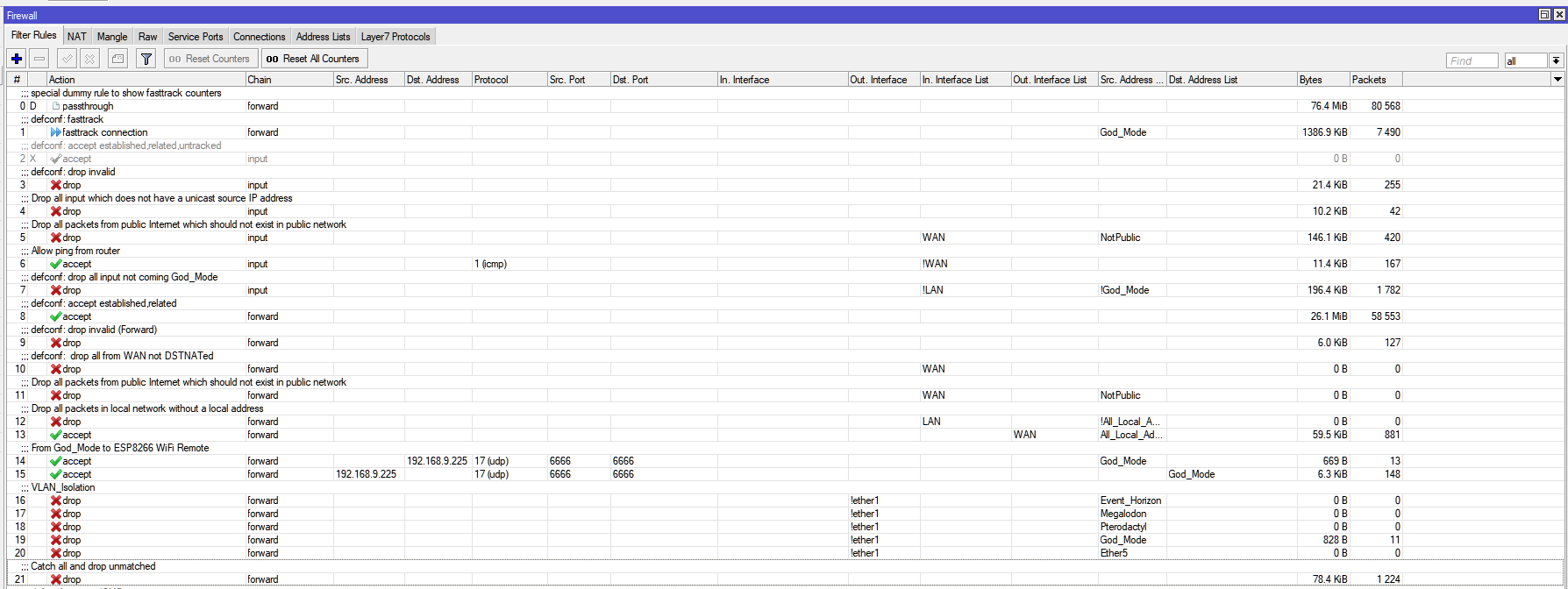

I have some firewall rules that conflict with each other, and I thought that whichever rule was higher in the list would take priority, but that does not seem to be the case. I am trying to allow traffic between two IP address lists on UDP port 666. The VLAN isolation rules prevent traffic between IP address lists, but they are lower in the chain. As I send the UDP payload across the network, I can see the count increasing on the firewall rule for VLAN isolation, and my packets are never being delivered. Does anyone know what I am doing wrong, or could this be a bug? Rule number 5 and 10 are the conflicting rules.
First question: do you also see the counts for rule 5 or 6 increasing, or just 10? If not, something is wrong with your specification in 5 and 6.
5 and 6 are basically configured the exact same except inversed. So the source and destination are backwards in each rule. The packets on 6 are counting up, and I can receive UDP packets from that network but the rule number 5 that should allow them in the opposite direction is failing. It doesn’t count any packets. Instead, rule number 10 is counting those packets.
Ah, well, then, clearly something in rule 5 is deficient and is not matching the packets. It could be something that doesn’t show in the Winbox window because it’s in a column you aren’t showing, like perhaps the TCP flags or whatever.
Use the CLI to do a /ip firewall filter print, and look for some detail that’s different between 5 and 6.

Thank you, that is very helpful. The issue that was causing the packets to get dropped was because my android app was choosing a random port in the 50,000 range rather than the local port I was requesting. I used a different constructor in my code to bind the local port, and it started sending from the correct one.
As for the VLANs and such, they are all isolated VLANs on the WiFi and a couple of isolated LANs on the physical interfaces. I didn’t realize I should just give them Internet access and drop all else. I think at one point when I had the default config everything was reachable from every VLAN and that was the only way I could get them all isolated. Maybe I missed something in the initial setup, and I should start from scratch. How do I grant Internet access to each VLAN individually? What is the best way to do that?
Ok, I put in a rule to allow all local IP address lists to access WAN destination interface list, and that gave them internet access. I added a rule at the end to drop all the unmatched packets. But if I disable the VLAN isolation rule, I can still ping across any of the VLANs.
Since you have changed things from your original screen capture, please post you current firewall rules.
Ok, here you go.
