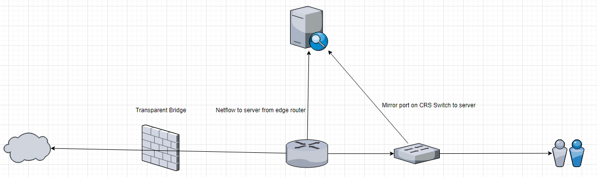

From the above image, we have a 4011 acting as a transparent firewall all the port are in the bridge and the firewall is enabled on the bridge.
Then on the we used a CCR as an edge router and NetFlow is enabled and streaming to the server. A direct cable to the server is preferred this will also act as the management port
let say it will be eth0 on the server.
Then the switch is a CRS series and this is important because you are able to mirror ports. The mirrored port does not have to be part of the bridge.
So all the traffic is entering spf1 then we will mirror sfp1 to sfp3 which is connected to the server on eth1. On the server eth1 will be the monitored port. Be warned this will send both tx and rx data to the server

This software will be using the mirrored port on the CRS. The CRS will be streaming live traffic to the server and Suricata/Snort/Zeek will analyze it
Then we use the ELK stack for visuals Elasticsearch Kibana Logstash/Filebeat.
The reason for this kind of setup its that the server does not interrupt the traffic flow but manipulate it through the transparent firewall so in the event the server fails you would still be up and running
Always make static entries on your firewall 1st in case of failure by the server you would still be protected
