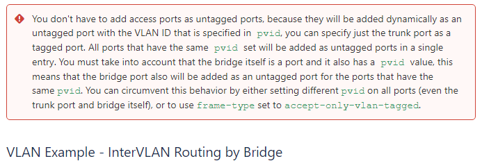

In the v7 docs they left out the explicit untagged ports in the /interface bridge vlan stanza for the access ports. The ports will be added as untagged “automatically” if they are specified with pvid in the /interface/bridge/port stanza, but won’t show up in the config, and I think the v6 way, although more “wordy”, makes the config export much easier to understand the intent. But to really understand, you need to know that either will create a config that behaves the same. The output of /interface/bridge/vlan/print detail is useful to see what ports are tagged and untagged for each vlan.
This is in the v7 docs:
