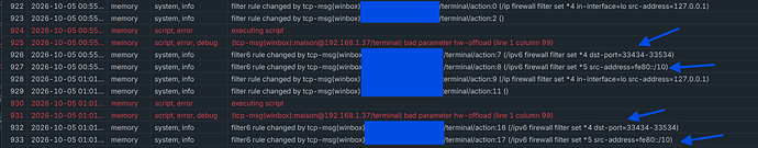

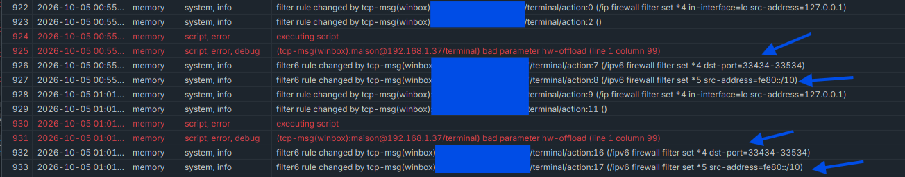

Sorry, I attached the wrong image. My question is: I ran the command twice—is it normal for the action number to change? For example, the first time it was 7, then the second time it became 16; the 8 changed to 17.
I don't know; I don't handle the logs, and what does "action" mean...
Action is not for sure the line number, probably is one incremental counter on action on command line...
