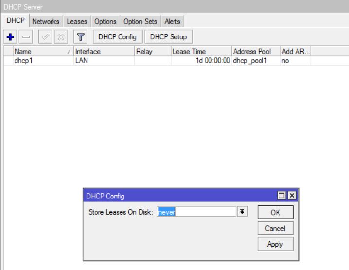

WinBox, IP DHCP server, DHCP config, Store Leases on disk → Never.
CLI:
>/ip dhcp-server config set store-leases-disk=never
That should do what you are requesting.

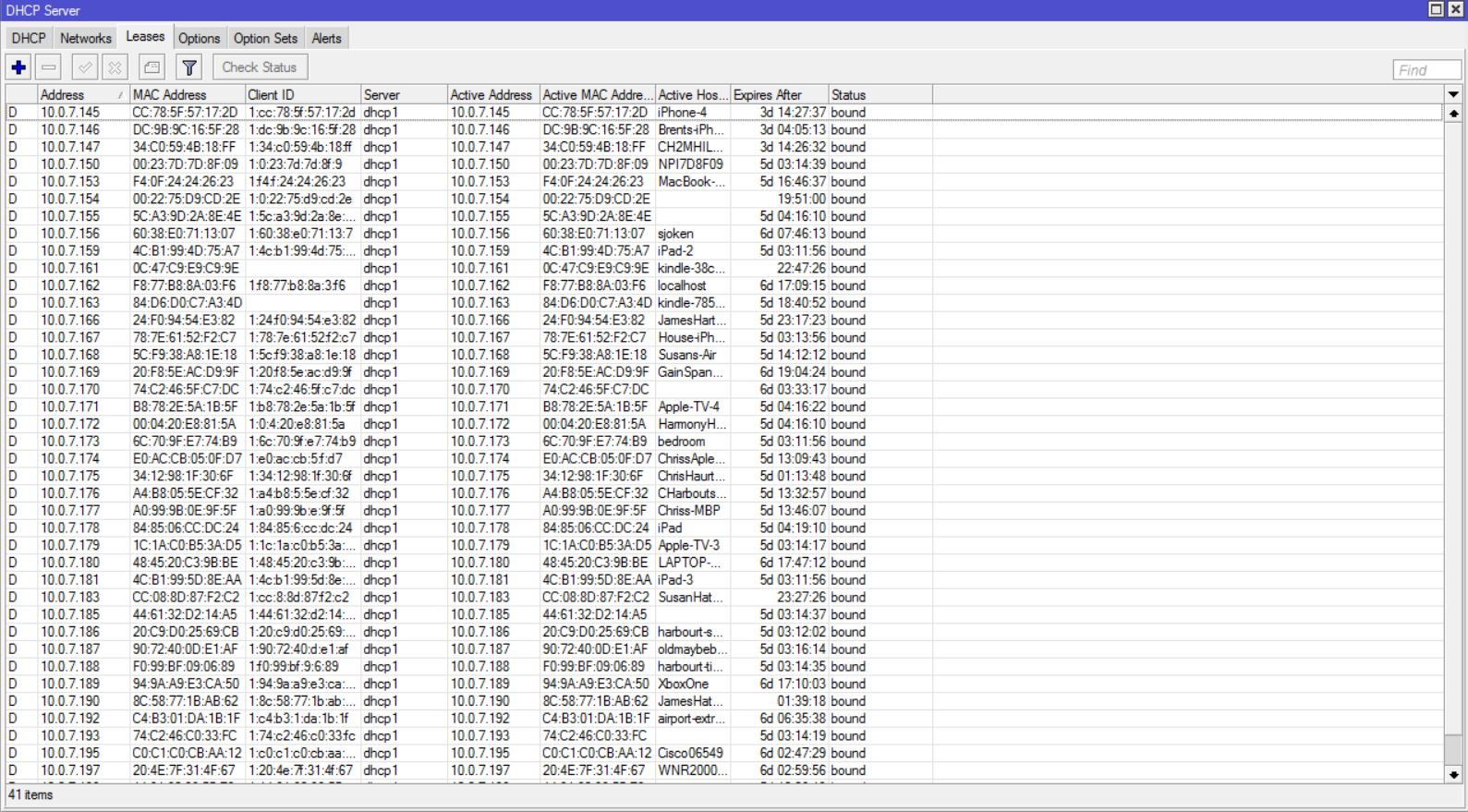

I did this, set it to not write to disk, rebooted, and it’s still holding DHCP leases. What’s worse, this site router is supposed to be handing DHCP down to the customer’s router, and the customer’s router is supposed to be supplying the end users’ devices with IP addresses. Somehow, the site router is handing out IP’s to the customers’ devices. I changed lease time from 1 week to 1 day, set it to not write dhcp to disk, rebooted and the leases are all still there. I attached a pic so you can see. None of my other routers are doing this, v6.38.3 on RB850GX2. Any ideas??
