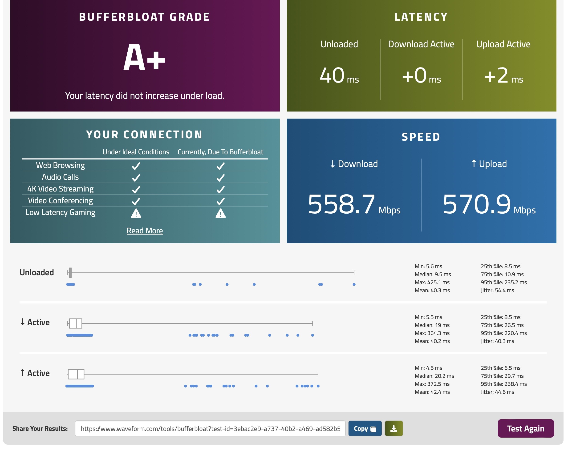

..and here you can find the results. I have 500Mb/s symmetrical nominal, but I get 620Mb/s measured.
