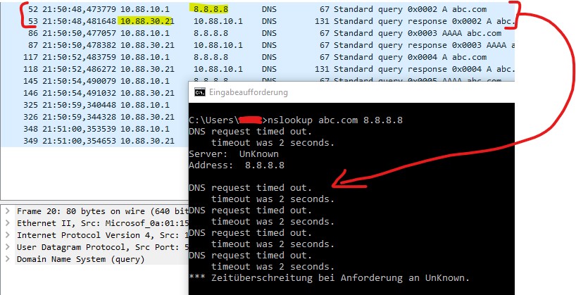

Assuming the client tries to contact 8.8.8.8, the DNAT-rule catches the frame and forwards it to 192.168.10.4.
The DNS-server will process the request and … what will happen, my dear ANAV!!!
The IP-Stack of the server will send the frame back to the source-IP of the inital frame. Someting out of the 192.168.10.0/24 network. The (inital) client will see a DNS-packet coming from 192.168.10.4. But he contacted 8.8.8.8. This will become invalid and gets silently dropped.
The only way to fix this is an additional SNAT rule which makes the DNS-server send the frame back to the router (insted of directly to the client). The Router will undo the DNAT/SNAT and for the client the DNS-answer is from 8.8.8.8 (but it was processed by 192.128.10.4).
Thats a typically asymmetric fordwaring scenario, nasty stuff to find.

For all other, thats exactly the behaviour without a SNAT rule:
Outbonud: 10.88.10.1 → 8.8.8.8
Inbound: 10.88.30.21 → 10.88.10.1
The answer form 10.88.30.21 is invald, because an answer from 8.8.8.8 is awaited.
