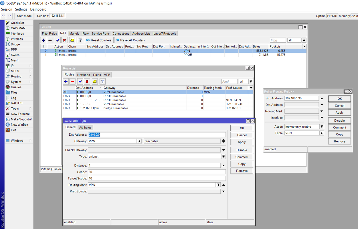

I did what you said, but it didn’t work. Look at the picture below
Looking at the masquerade rule counters, I’d say the setup works, but the VPN provider checks TTL of packets and drops them if the TTL is too low, which indicates that the L2TP client is a router, not a computer.
Open a commandline window using the [Terminal] button, make it as wide as your screen allows, and run /tool sniffer quick interface=VPN ip-protocol=icmp in it while pinging something like 9.9.9.9 from the 192.168.1.95; if it shows the ping requests to be sent from 172.31.x.x to 9.9.9.9 but no responses to come back, it is likely to be the case, and you’ll need a mangle rule to adjust the TTL. To use mangle rules, you have to prevent the traffic that needs to be modified by them from getting fasttracked. Or maybe the responses do come but with TTL reduced to 1 so the router drops them rather than forwarding them - this can also be overcome with a mangle rule.
