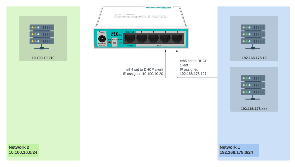

I have the following topology.
  • Network 1: 192.168.178.0/24, this network has it’s own DHCP server.
  • Network 2: 10.100.10.0/24, this network has it’s own DHCP server.
    These 2 networks are seperated from eachother.
I have a device on the 10.100.10.0/24 network: 10.100.10.210 which has a HTTP server running on port 80. On the other network (192.168.178.0/24) there are multiple devices. I would like the devices on the 192.168.178.0/24 network to be able to connect to the HTTP server that’s running on the 10.100.10.210 device.
I have tried the following:
  • Connected port 5 of the hEX lite to network 1 (192.168.178.0/24) and I have configured this interface as DHCP client, it receives the following IP: 192.168.178.121.
  • Connected port 4 of the hEX lite to network 2 (10.100.10.0/24) and I have configured this interface as DHCP client, it receives the following IP: 10.100.10.20.
  • Added the following to the firewall nat:
chain=dstnat action=dst-nat to-addresses=10.100.10.210 to-ports=80 protocol=tcp in-interface=ether5 dst-port=80 log=yes log-prefix=""
When I connect my computer to 192.168.178.1/24 and try to visit 192.168.178.121 in my browser I am not able to connect to the HTTP server. The goal is to forward the HTTP request that is send to 192.168.178.121 (hEX lite) to the 10.100.10.20 device. I think this is the same type of configuration as port forwarding with the WAN interface but I want to use the 2 LAN ports.
I hope this makes sense, if there other methods of doing this please let me know.

This is an overview of the topology:
This is my configuration:

Interface eth1 is has the default settings and is not used in my setup. I am only using eth4 and eth5.

Maybe my choice of interface configuration is wrong, let me try to describe the problem again. When devices of the 192.168.178.0/24 network access port 80 on ip 192.168.178.121 then these requests should be forwarded to port 80 on 10.100.10.210. This way the devices on 192.168.178.0/24 can only access port 80 of a single device (192.168.178.121) in the 10.100.10.0/24 network.
