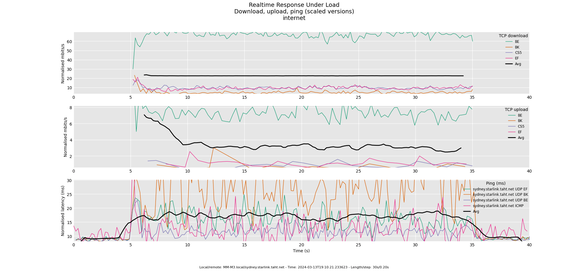

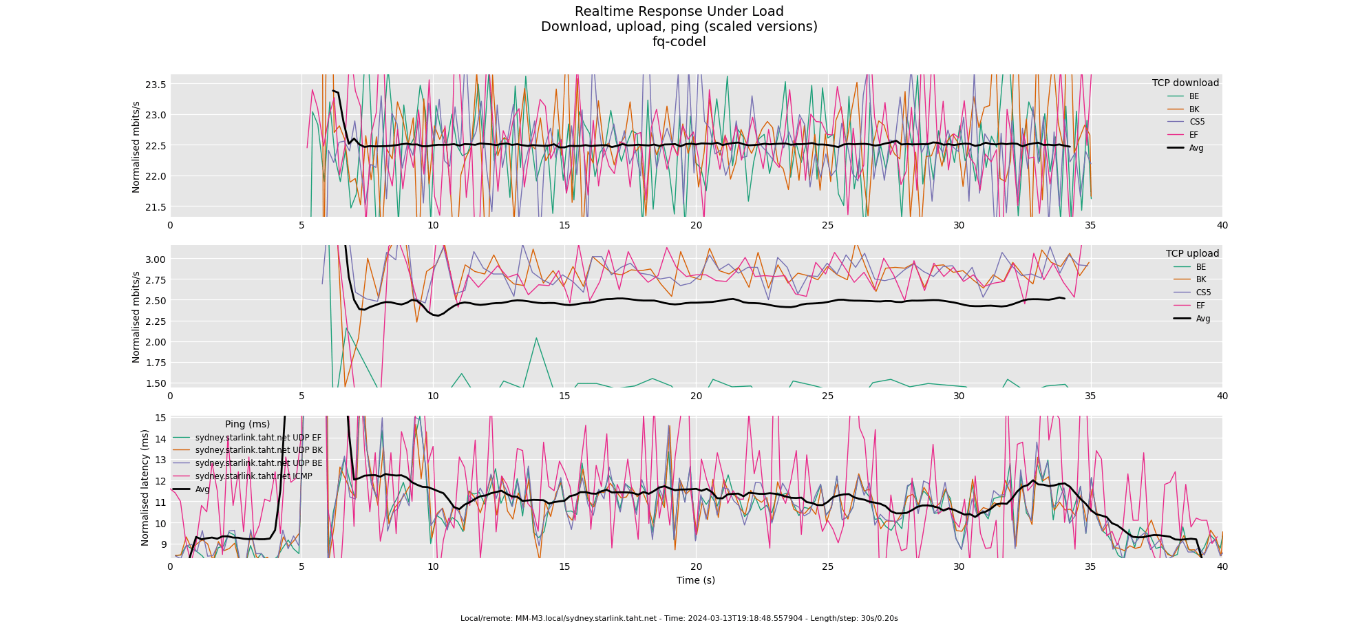

I played with rrul a while back. I can’t remember exact settings, would have been simple queue on my 100 DL / 20 UL connection with 95 DL / 15 UL limits.
What I found cool was how you can clearly see diffserv4 in action.
Right now I am running CAKE on a queue tree with fasttrack enabled on both ipv4 and ipv6 (7.18beta testing).
Previously I had fasttack disabled and mangle rules classifying stuff with dscp marks for diffserv, but I don’t trust my mangling ability enough to keep that setup.
No queues:
fq_codel:
CAKE dual-src/dsthost diffserv4 nat internet:
typically you can put cake with the exact, correct, framing hard up against the upload limit (and also use ack-filter there). On downloads, tho, no more than 92%. And thx for playing with rrul!
