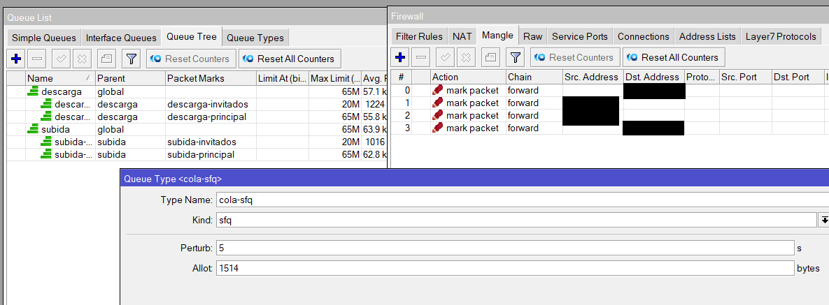

CAKE on DD-WRT worked much better than Mikrotik’s SFQ queue tree but it’s too unstable for home networking (wifi crashes, wan drops, etc), consider adding CAKE queue type instead of FQ-Codel since it provides the lowest fluctuations during heavy load, http://www.dslreports.com/speedtest/63079766 this is what I get with MK solution but the latency spikes up to 300ms while CAKE consistently mantained it under 130ms giving me A+ ratings.
Edit: this is my current config
